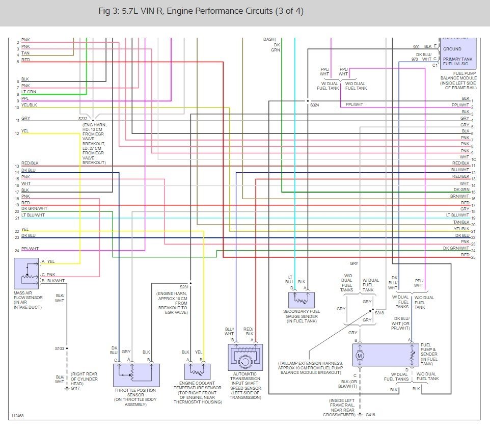

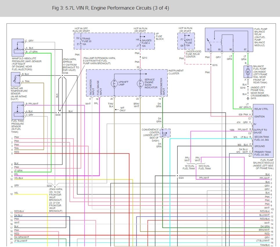

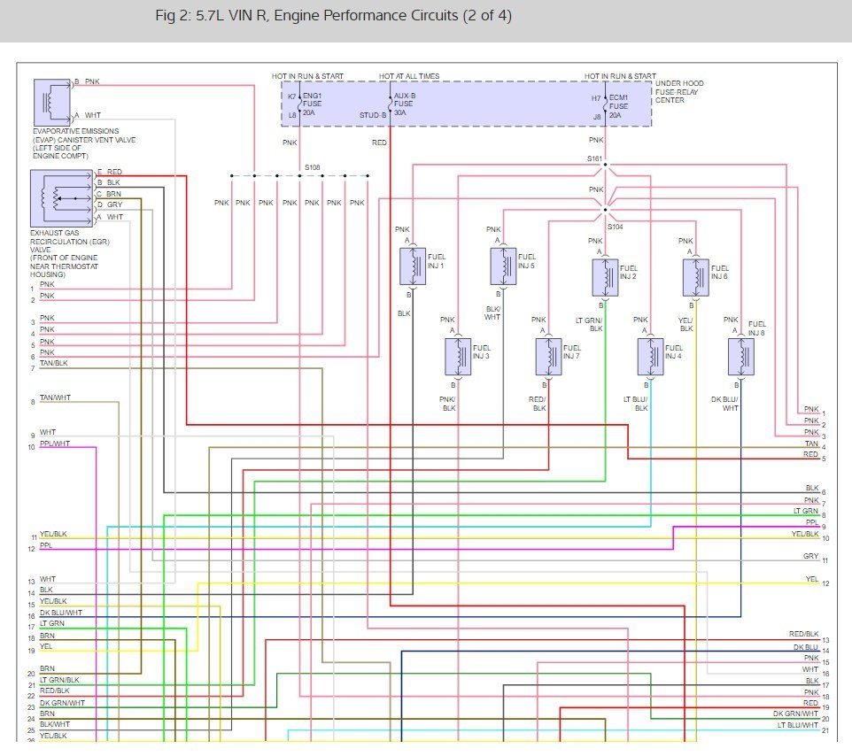

My 1999 Chevy Suburban 1500 is running real rough, can not clear codes and can not get a reading on MAF. What be causing this? Would aa broken ground wire be the cause? Please help
May 31, 2017 at 4:03 AM
  • 55,433 POSTS

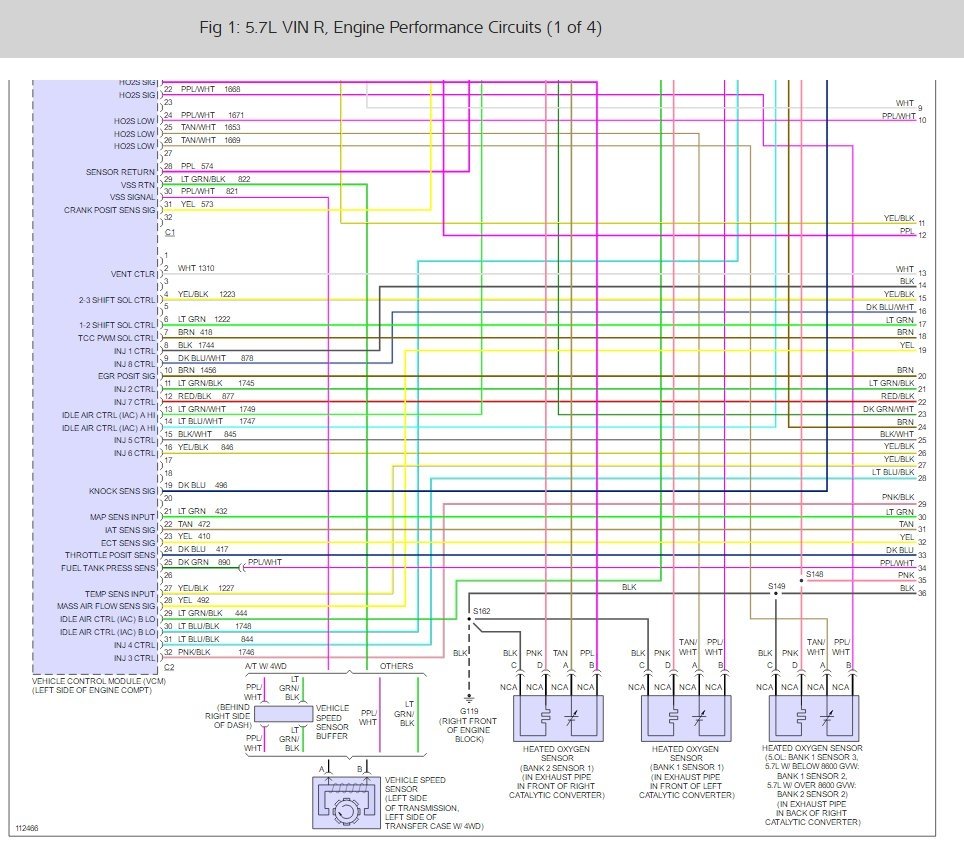

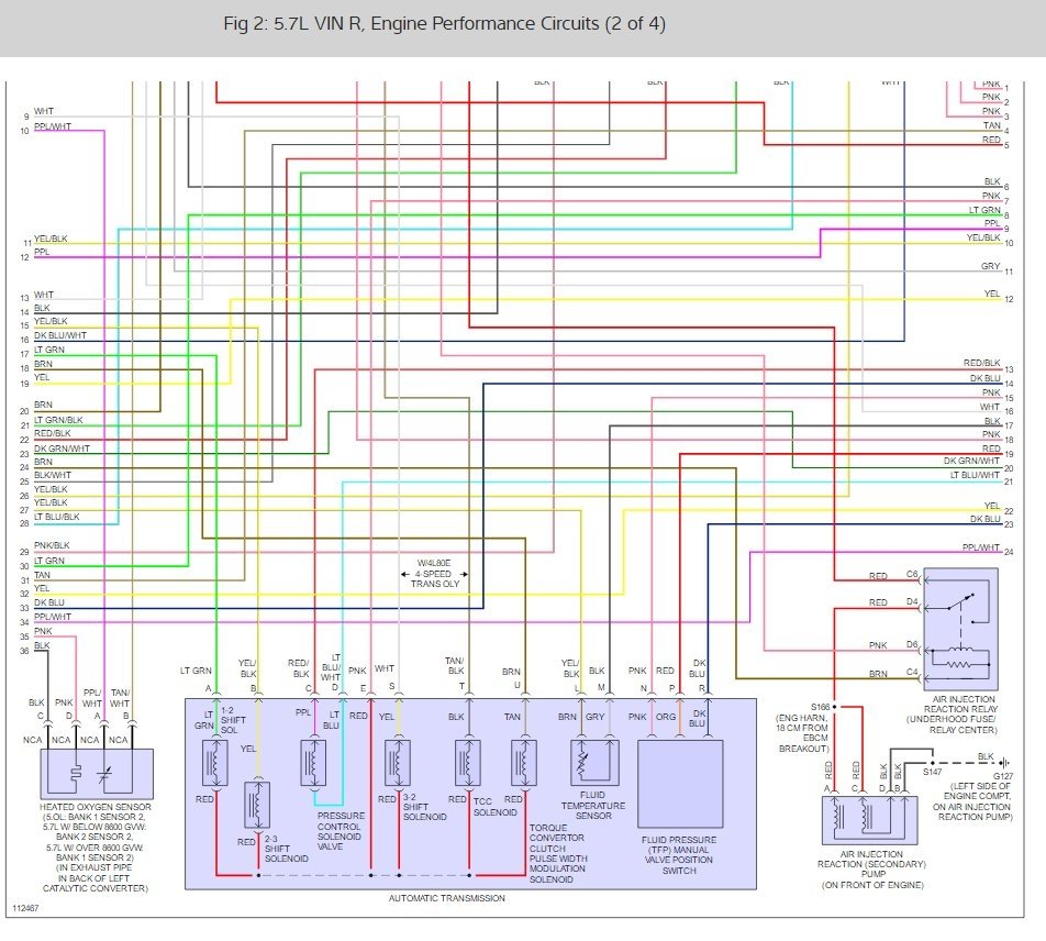

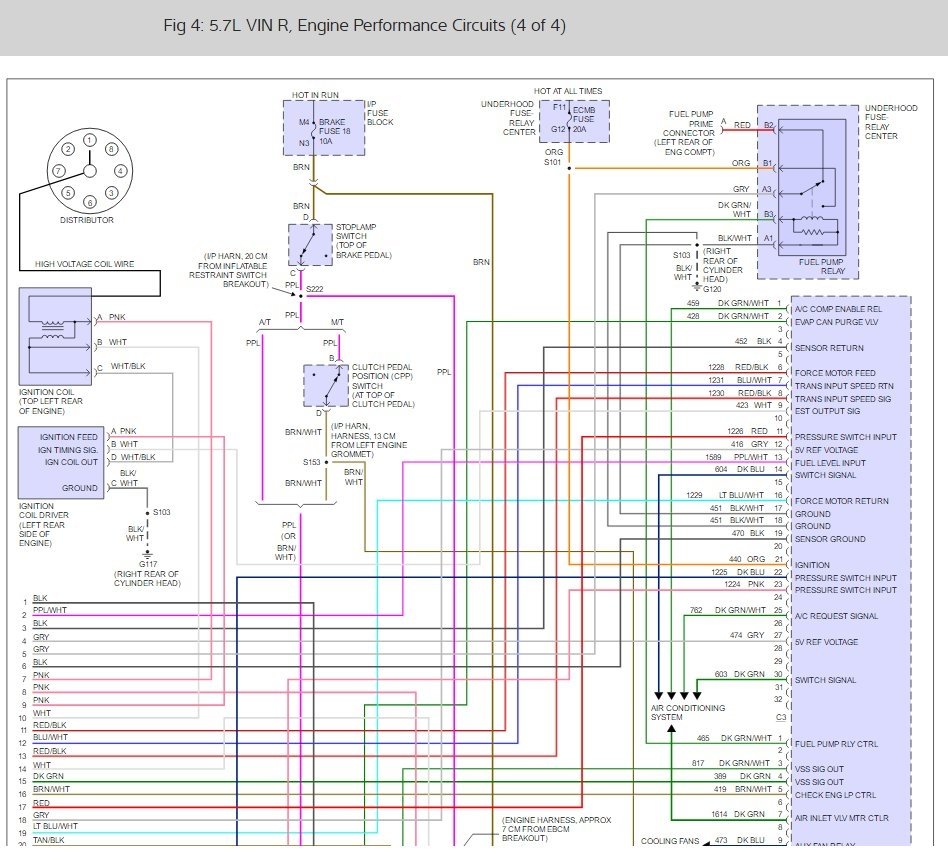

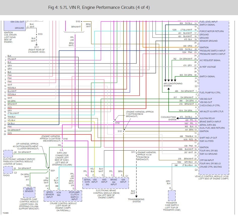

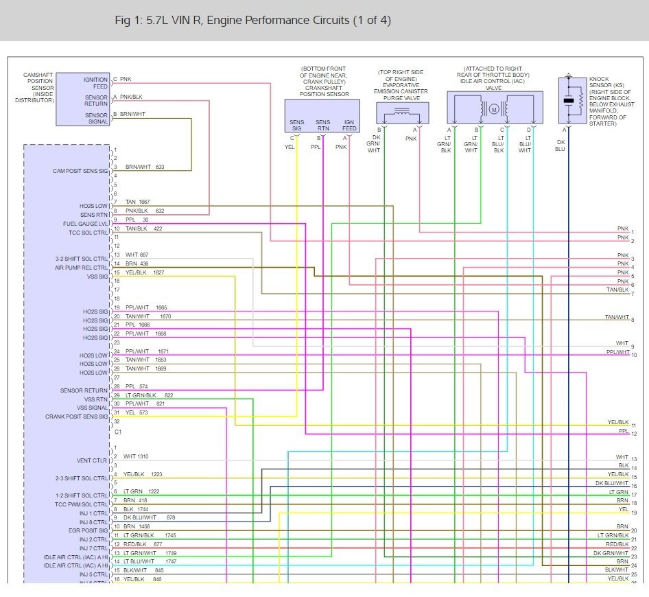

Yes a broken wire can cause this also a bad MAF sensor can as well. Here are some guides that will show you how and some diagrams (BELOW) so you can do some testing.
https://www.2carpros.com/articles/how-to-replace-a-mass-air-flow-sensor-maf
and
Please run some tests and get back to us so we can continue helping you.
