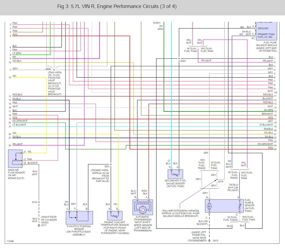

Car runs nicely for several days then quits. will restart but usually quits when i try to move it. mass flow sensor has been cleaned

A code P0102 may mean that one or more of the following has happened:
The MAF may be disconnected, or a wiring connection may be bad
The MAF may be dirty or otherwise contaminated (Note: if you use a reusable oiled air filter, be careful not to apply too much oil or that can contaminate the MAF).
The MAF sensor may be faulty
The vehicle computer may be faulty (very rare)
Possible SolutionsThe simplest thing to do is to reset the code and see if it comes back. Then start with the cheapest, easiest repair procedures:
Verify that the Mass Air Flow Sensor wiring is connected properly and that there are no broken / frayed wires.
Inspect for any air leaks near the MAF sensor.
Take the MAF out and clean it using a spray cleaner such as brake cleaner or electrical contact cleaner. Be gentle with the sensor.
Check the voltage of the MAF sensor (refer to a repair manual for vehicle specific information)
Replace the MAF sensor.

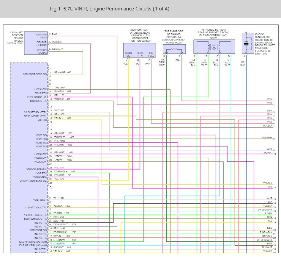

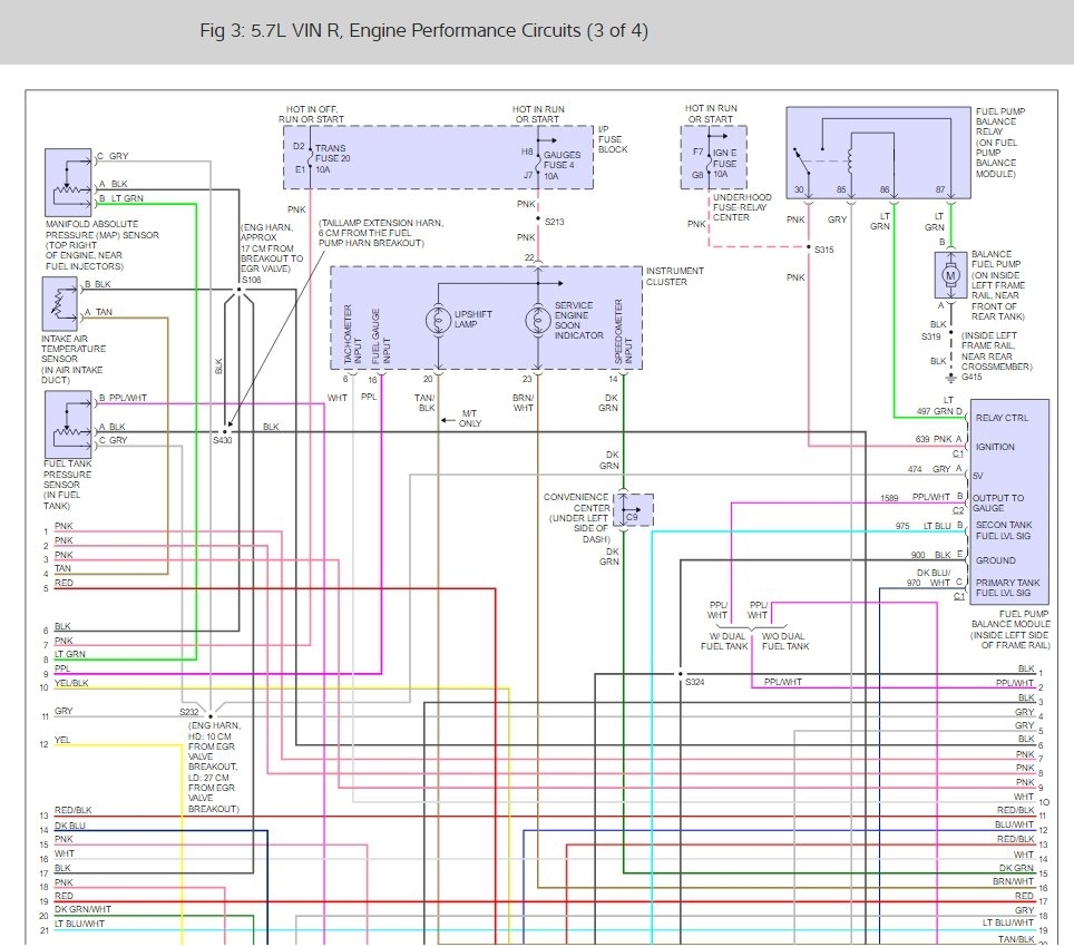

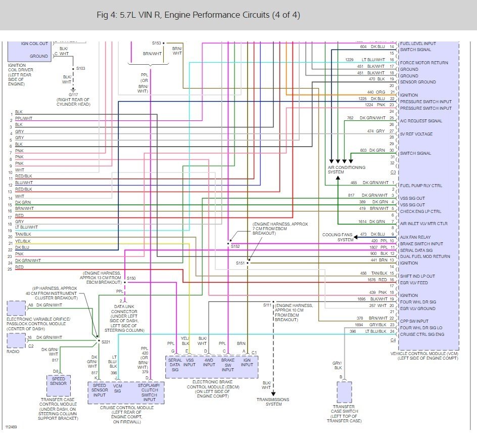

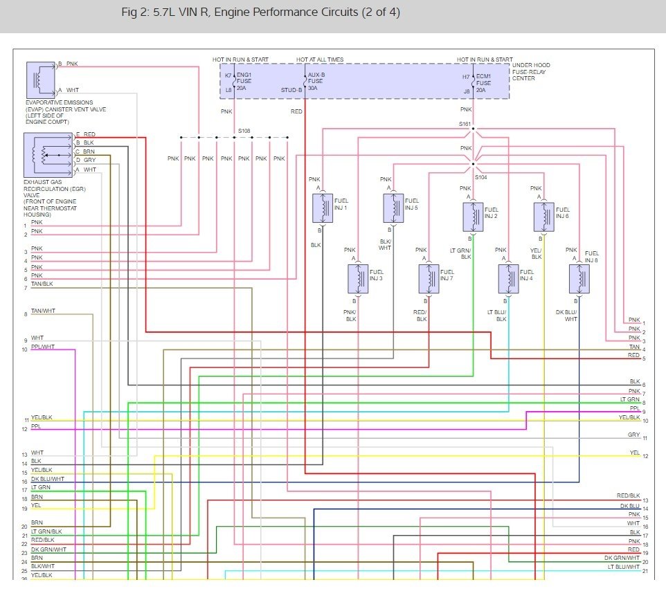

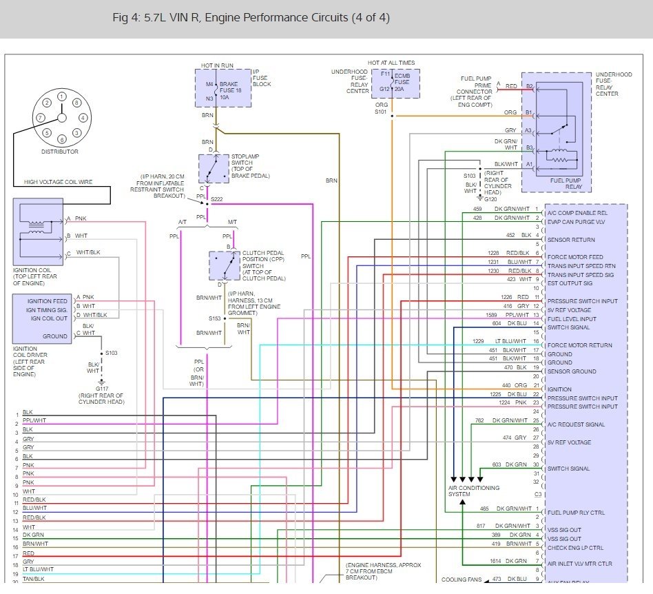

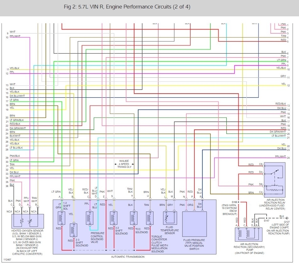

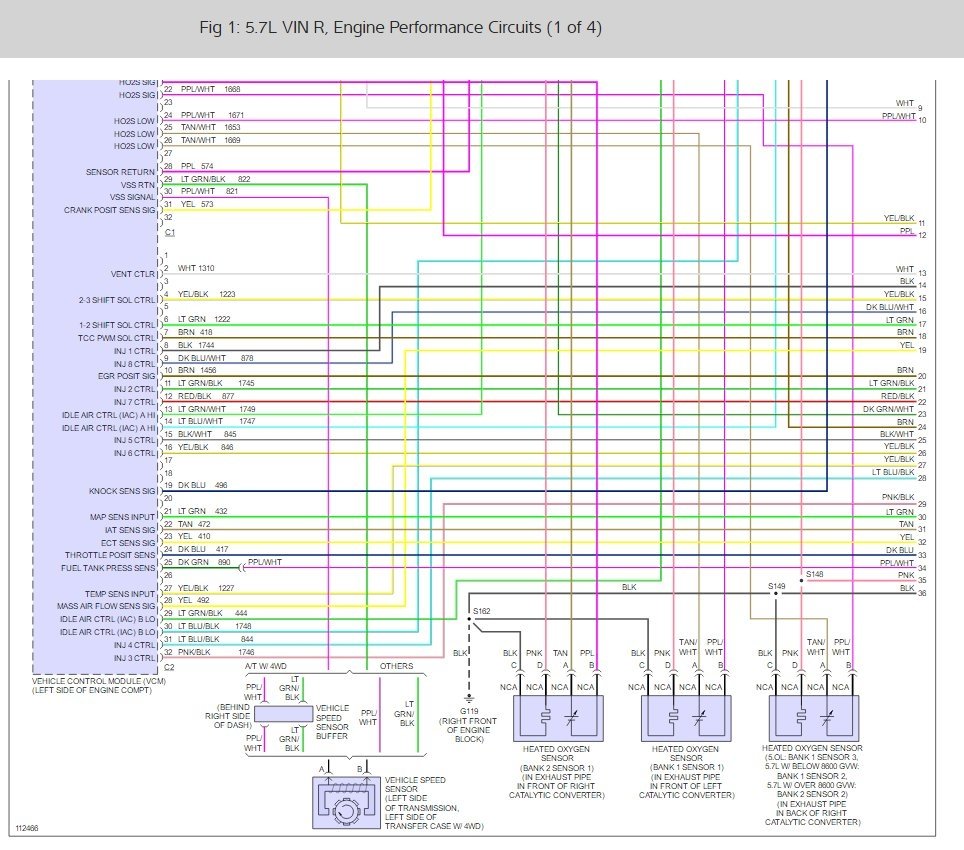

My 1999 Chevy Suburban 1500 is running real rough, can not clear codes and can not get a reading on MAF. What be causing this? Would aa broken ground wire be the cause? Please help
May 31, 2017 at 11:03 AM
  • 54,837 POSTS
Yes a broken wire can cause this also a bad MAF sensor can as well. Here are some guides that will show you how and some diagrams (BELOW) so you can do some testing.
https://www.2carpros.com/articles/how-to-replace-a-mass-air-flow-sensor-maf
and
Please run some tests and get back to us so we can continue helping you.
