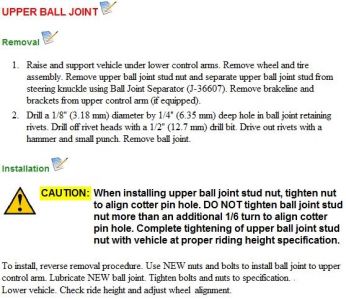

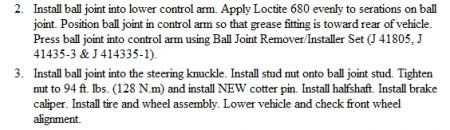

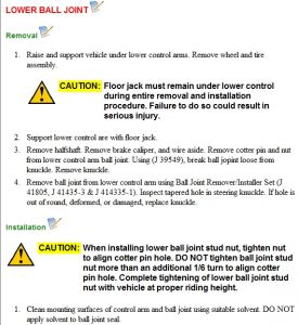

How difficult is replacing the upper and lower ball joints?
The easy way being $700.00 at a shop - how about the hard way, in my driveway?
This was discovered today when I attempted to have the front end aligned before a cross country trip (California to North Carolina).
