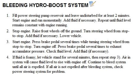

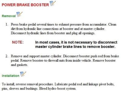

My brakes are hard and from all the reading I have done and some testing it seems that I have a bad brake booster. I was looking at getting some instructions on how to replace that. I am a bit scared of just jumping right in.

https://images.2carpros.com/forum/automotive_pictures/261618_Noname_2363.jpg
https://images.2carpros.com/forum/automotive_pictures/261618_Noname2_772.jpg
