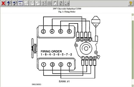

How do I know which one is cylinder#7 they told me it was misfiring
Wednesday, June 25th, 2008 AT 5:12 PM
MECHANIC
75,992 POSTS
See below
A misfire in a specific cylinder should lead you to check the spark plug, fuel injector and compression.
