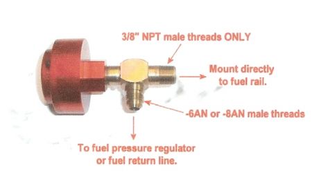

Pulse damper is designed to absorb the hydraulic pulsations in the fuel rail caused by injector opening and closing events. It will also help eliminate fuel pressure bounce and uneven fuel distribution. it's look like this:
https://images.2carpros.com/forum/automotive_pictures/46384_scan_5.jpg
[img]
