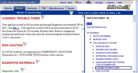

Inspect and test the Knock Sensor also see below for clearing code procedures
https://images.2carpros.com/forum/automotive_pictures/12900_clearing_1.jpg
