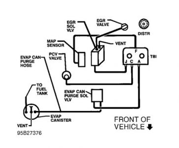

hey i have a egr problem when i rev the engine a little it pulls the egr valve open to much and the engine will almost stall but if i unplugg the the hose it will run fine but i wont to fix it the right way can you help

check to see if your egr solonoid is sticking or staying on. If not then your egr may need replacement as the spring may be to weak
