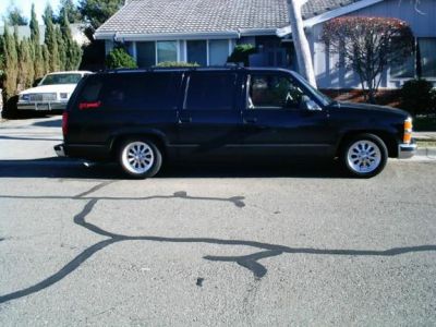

I just had a major tune up done on my truck. now after picking it up it drove ok, but now it wants to die while im driving. they also replaced the fuel pressure regulator, and flushed out my fuel lines. after i got it i put $20 in gas and now my fuel gauge shows almost empty and i havent driven anywhere to cause the drop.[img:3af13231af]http://www.2carpros.com/forum/automotive_pictures/482283_side_burban_1.jpg[/img:3af13231af]
