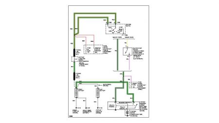

Vehicle wont start. All lights and electrical components seem to be functioning. When the problem first occured. I could pull on the positive battery cable and when the key is turned, the truck would start. Now that wont happen. I have replaced both battery terminals and tried to jump the car. When the key is turned there is only a single click, and nothing more.

Could be a starter problem. Check the 5amp fuse see below-if okay have helper hold key to start position and look for battery voltage on the purple wire at starter solenoid.
https://images.2carpros.com/forum/automotive_pictures/12900_fuse_5amp_1.jpg
https://images.2carpros.com/forum/automotive_pictures/12900_starter_circuit_2.jpg
