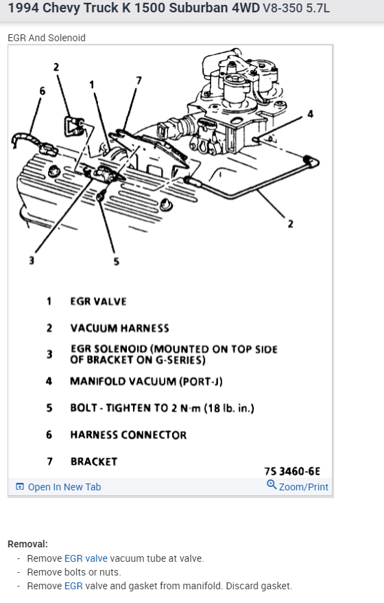

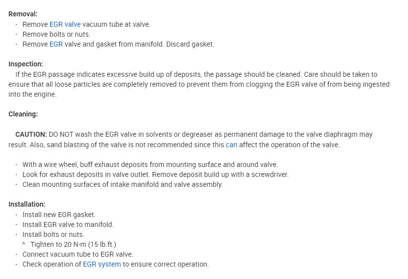

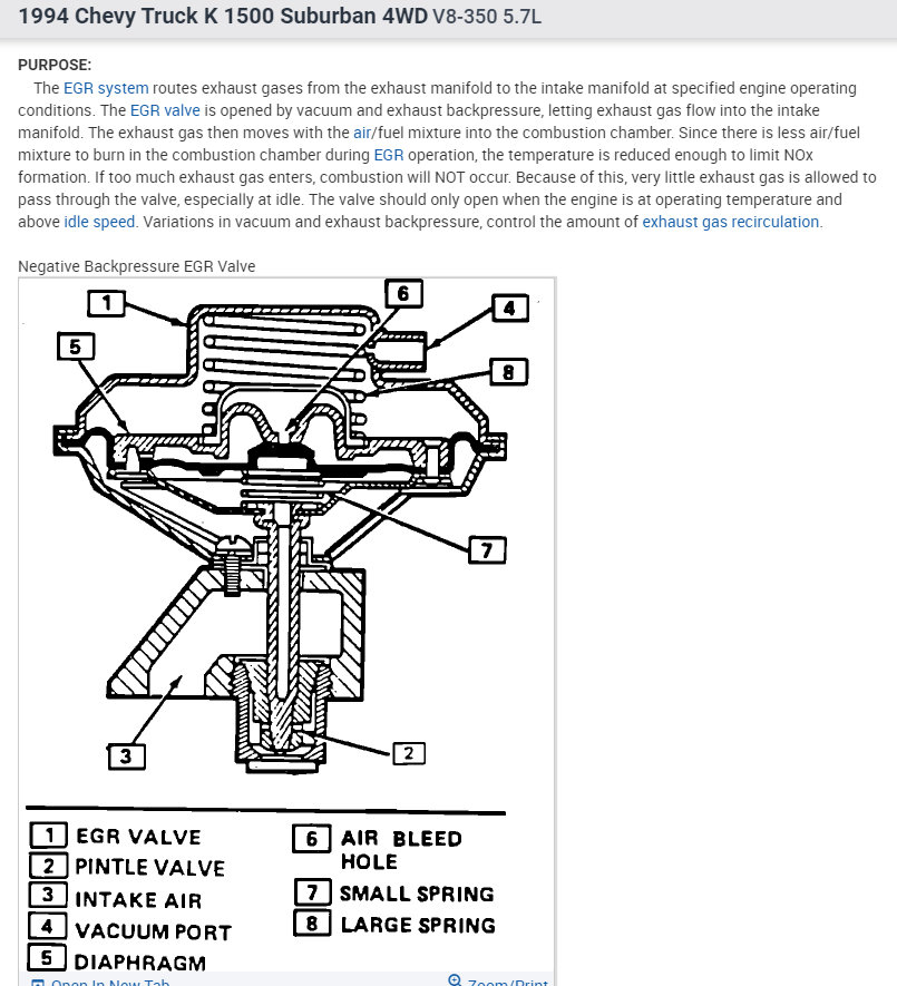

Re-check the egr. I know it's new. New parts are are not always good parts. It is a very easy test- when the engine is off, put vacuum pump on EGR valve and pump- valve should not move at all. If it does, it is junk.

Also, it will be a good idea to test the EGR valve to make sure it if functioning properly.
Here is a video of how to do that:
https://youtu.be/DqUCbbKdWf4
Clean out the EGR tube can also help.
