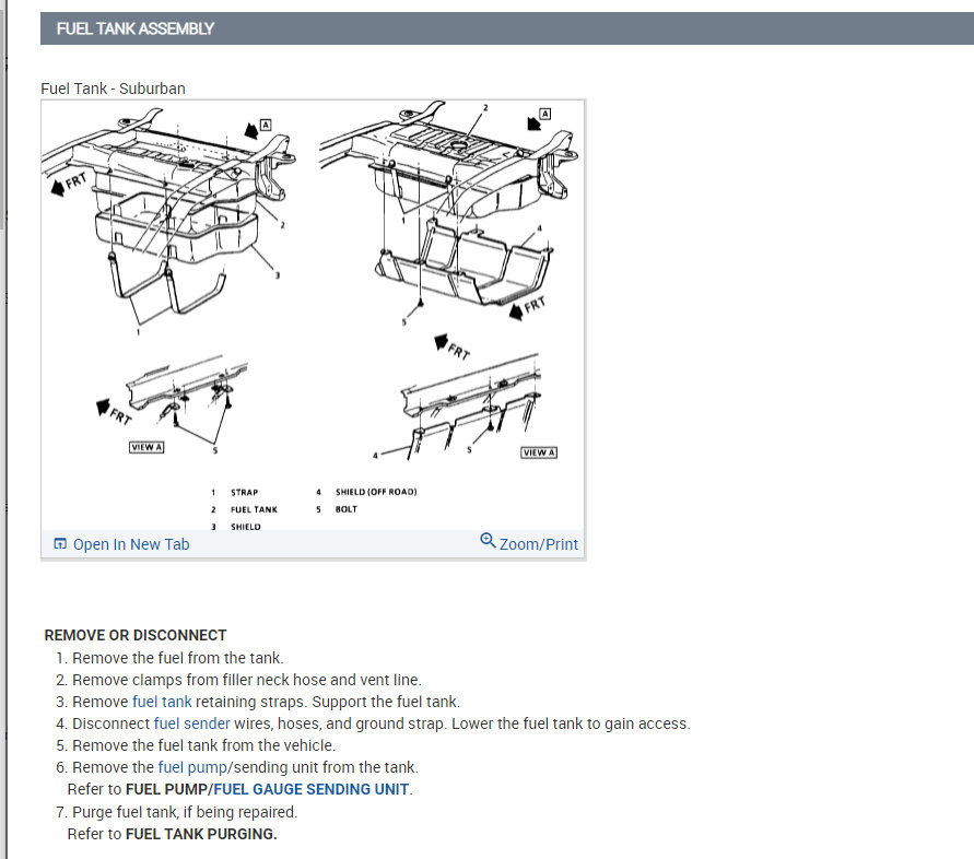

Can I get a video for removing the gas tank?
1993 CHEVROLET SUBURBAN
COBRA LL
how do you get the gas tank down?
Oct 27, 2009 at 2:48 PM
Here is a video that we have on a similar model year that shows how to replace a pump which includes taking the tank down:
https://www.youtube.com/watch?v=VuGxQgWDP-0

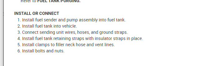

Below you will find the process from the manual on how to replace the tank which gives some detail on how to do this. It is not too difficult, just make sure the tank is empty.
Please let us know if you have other questions. Thanks
