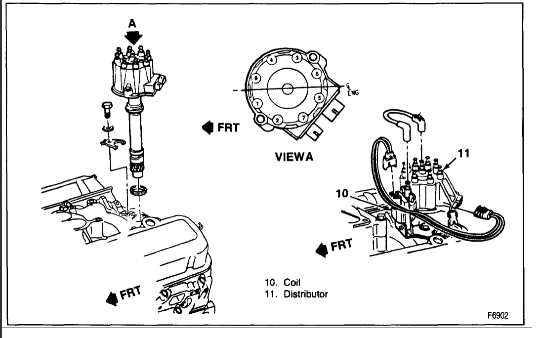

My truck will not idle in or out of gear. However, if I turn the steering wheel It will come out of it from time to time and run fine. If I turn the wheel again it goes right back to rough idle.

Has the check engine light ever come on? Here is a guide to help you get the codes:

Yes, it has a code 42.

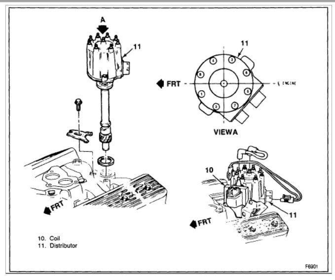

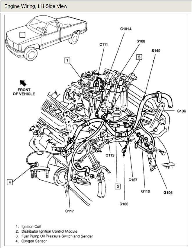

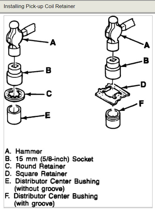

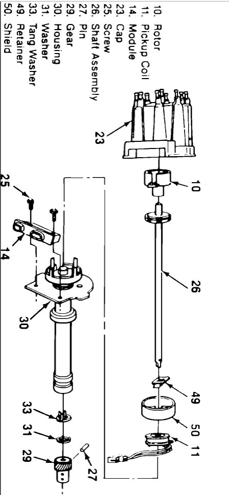

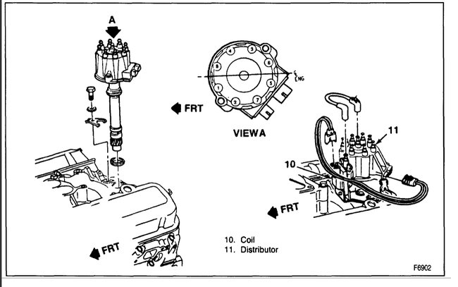

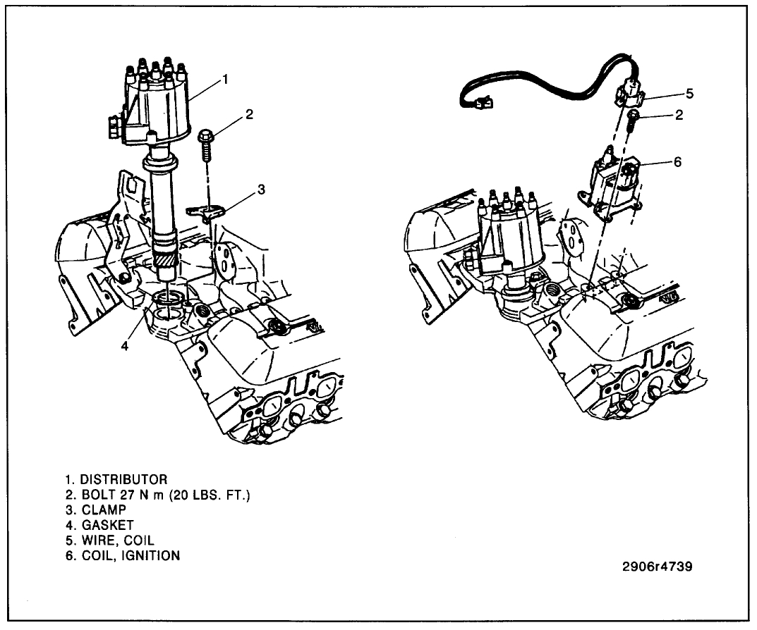

That is a code for the ignition module. Here is a guide to help you change it.
Cheers, Joe
