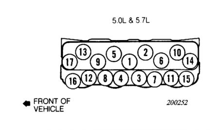

I have a 88 burban with a blown head gasket im curious as to what the torque specs are for the head bolts,and if theres a sequence for tightening the head bolts

Hi there, The bolt torque is 65 Ft lb, done in 3 passes as per pic.
https://images.2carpros.com/forum/automotive_pictures/61395_head_1.jpg
