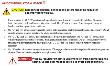

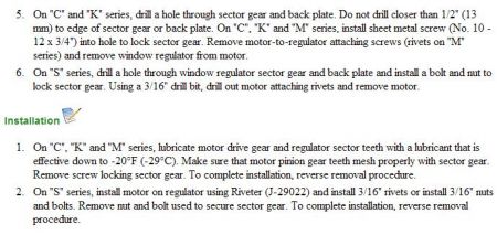

1986 Chevy Suburban removing window motor
1986 CHEVROLET SUBURBAN
CARLHOBSON
Interior problem
1986 Chevy Suburban V8 Two Wheel Drive Automatic
how do you remove window motor on 86 chevy k10 suburban?
Sep 18, 2009 at 12:49 AM
BLUELIGHTNIN6
  • 16,542 POSTS
https://images.2carpros.com/forum/automotive_pictures/261618_Noname_991.jpg
https://images.2carpros.com/forum/automotive_pictures/261618_Noname2_279.jpg
