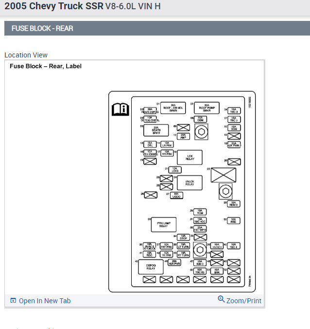

Drivers window stopped working and the top will not open as well?
Mar 23, 2010 at 2:25 PM
SQM
  • 6,383 POSTS

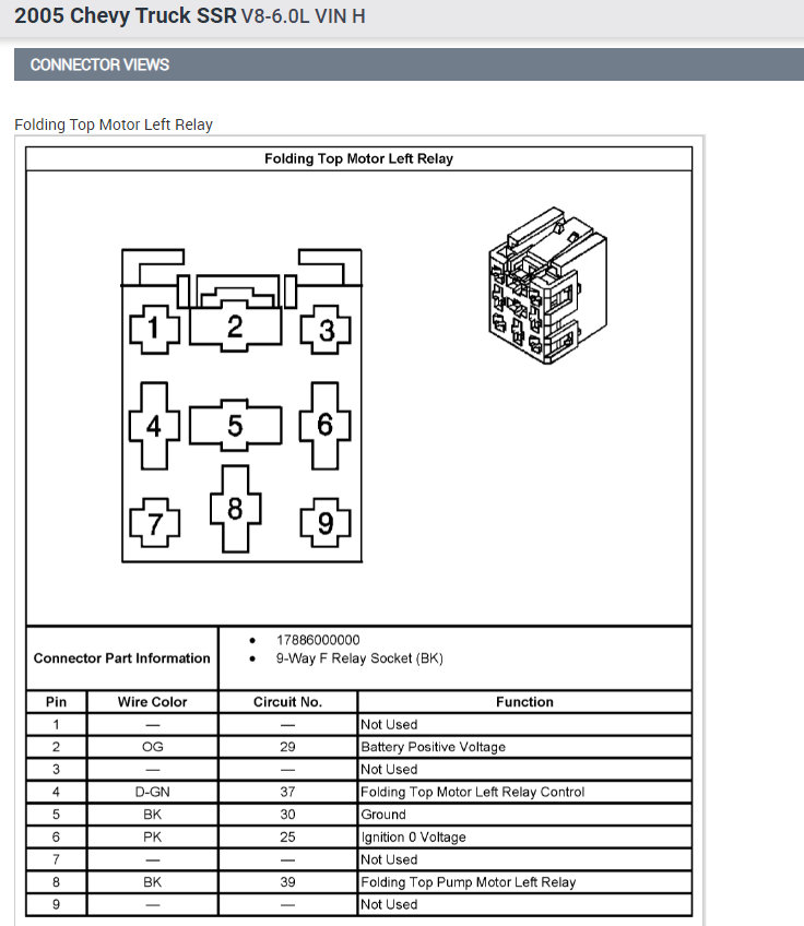

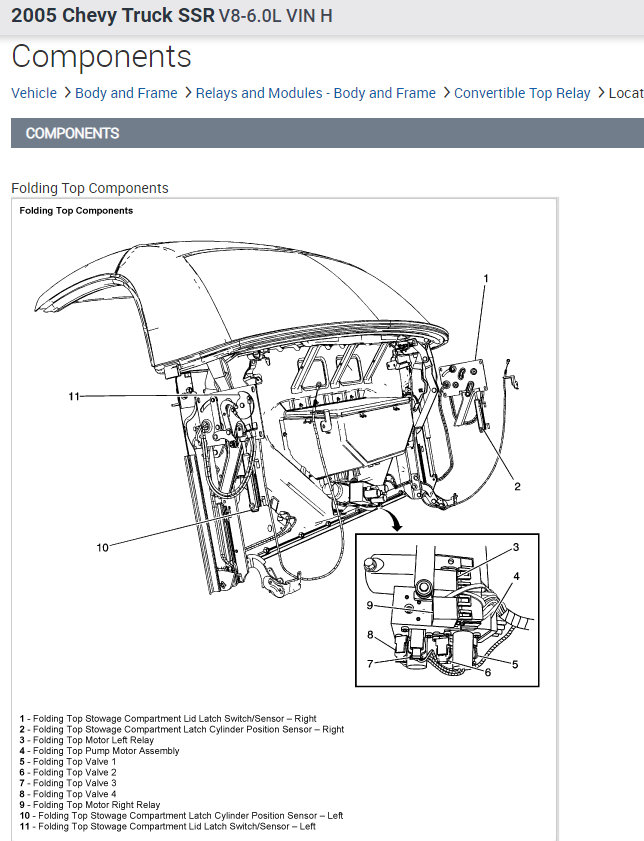

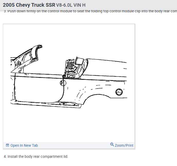

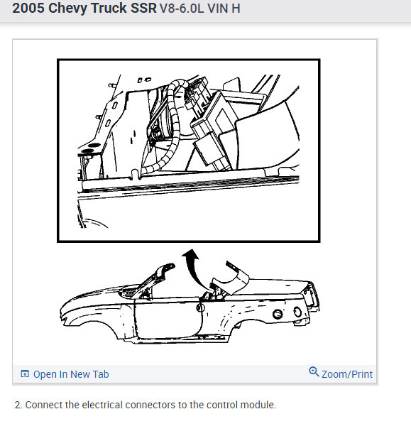

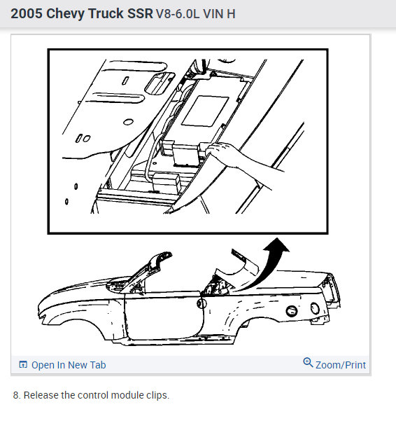

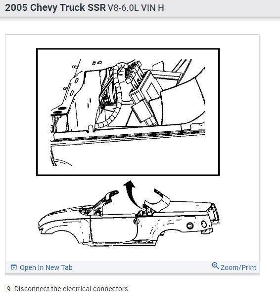

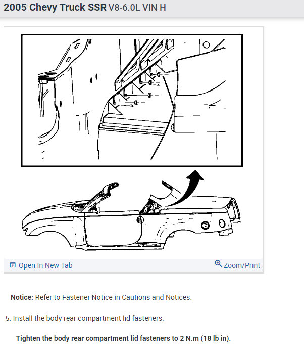

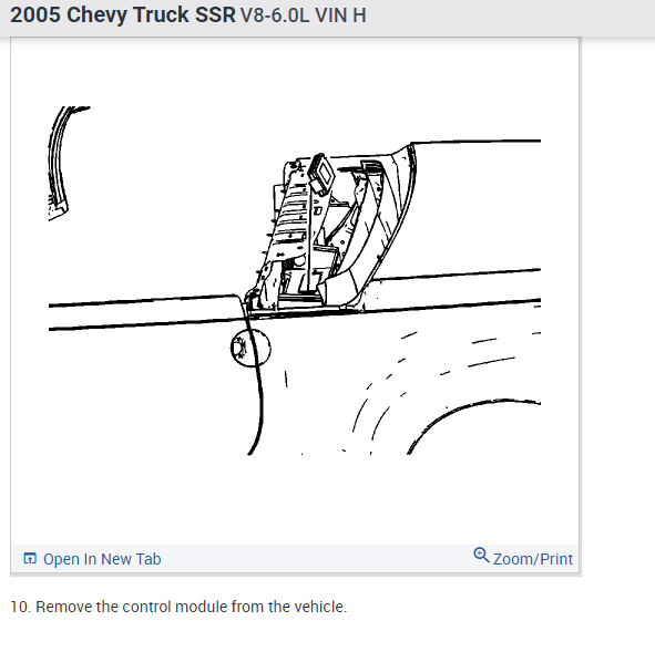

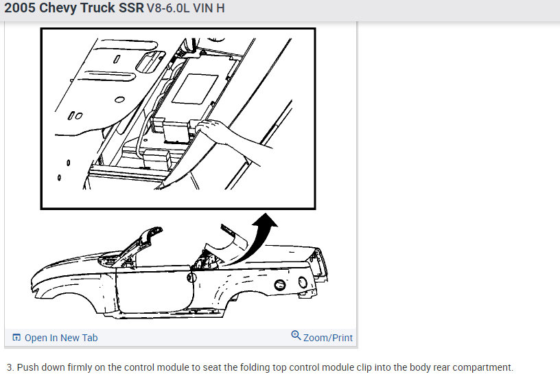

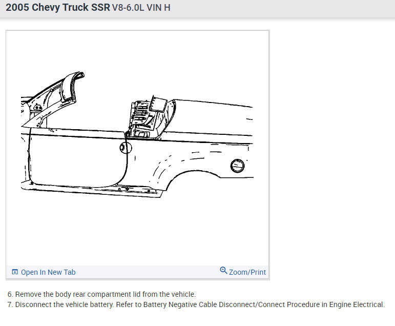

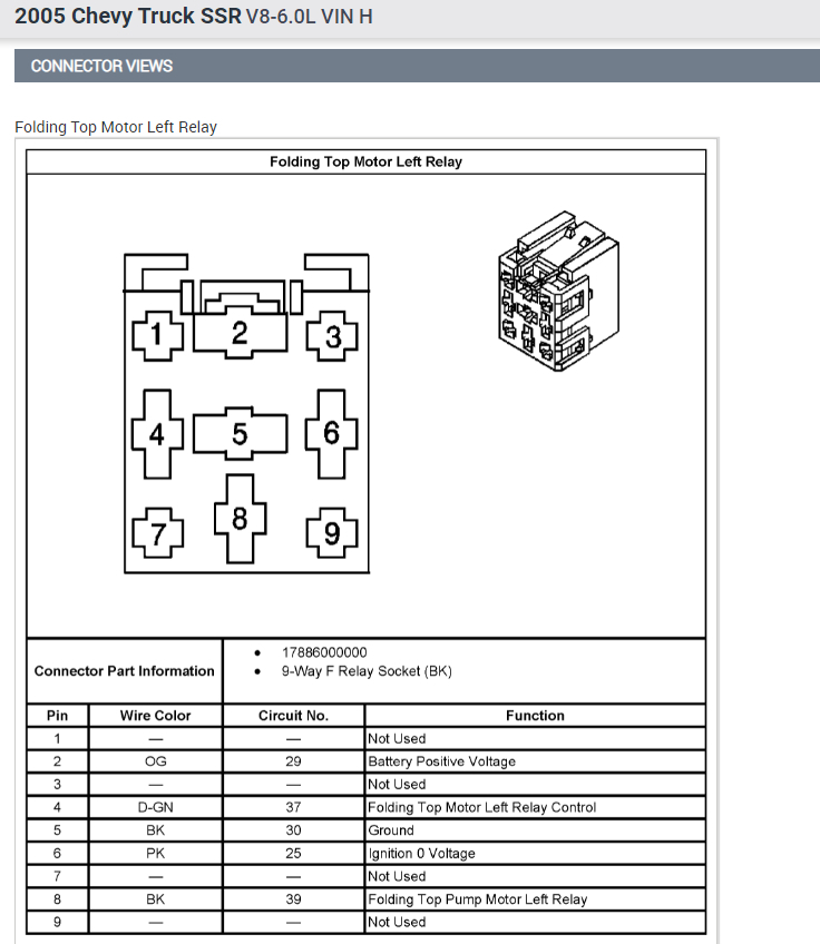

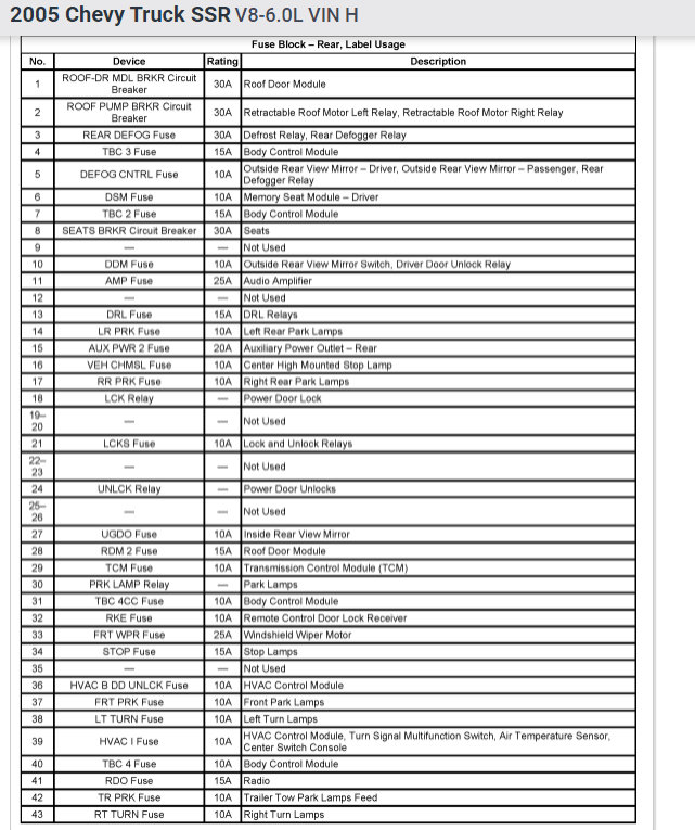

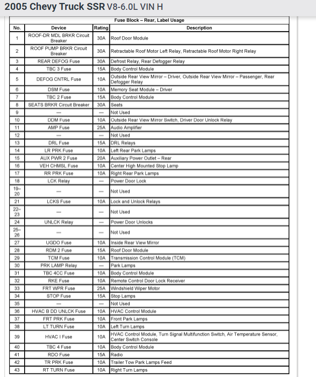

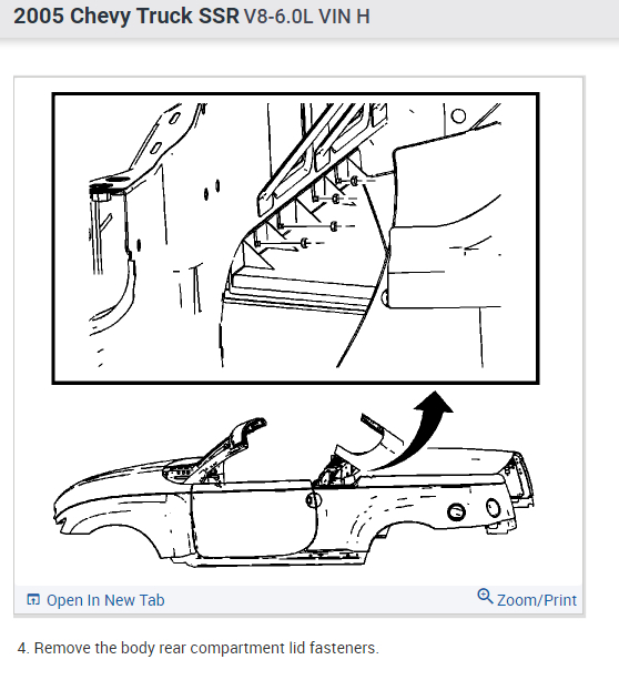

Check the fuse box in the rear, there is a relay for the folding top.
Do a visual inspection of the relay. Looks for any corrosion or burnt pin(s).
You can also test the relay:

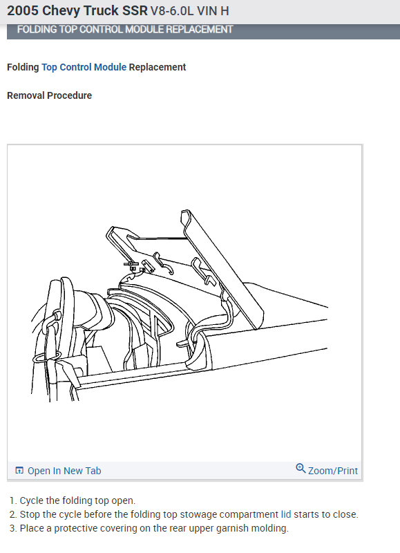

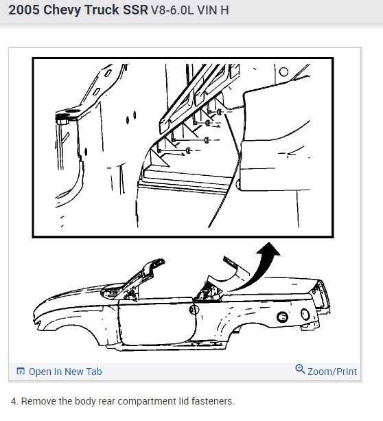

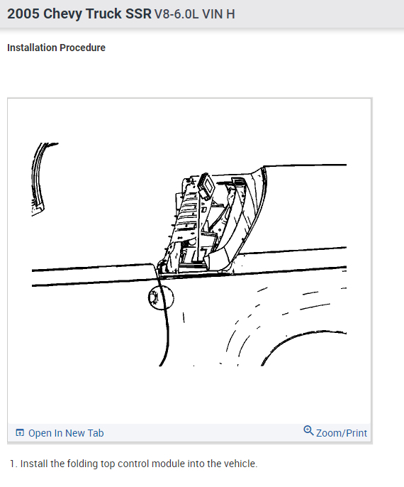

If the relay is good, then the issue is either the module for the folding top or bad top power motor.

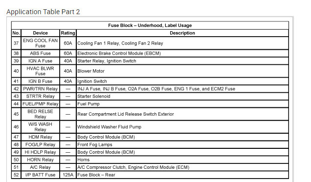

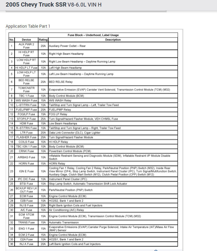

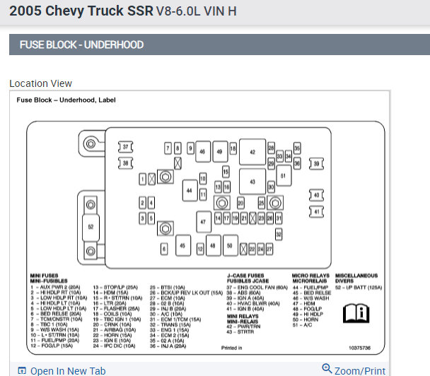

For the inoperative window motor check the fuse that is located in the under-hood fuse box.
