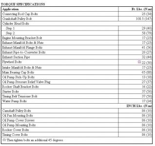

1987 Chevy Spectrum torque spect for head bolts
1987 CHEVROLET SPECTRUM
TONYCHALL2000
Engine Mechanical problem
1987 Chevy Spectrum 4 cyl Front Wheel Drive Automatic
I Need the torque on the head bolts
Apr 22, 2010 at 10:21 AM
KHLOW2008
  • 41,814 POSTS
Hi tonychall2000@yahoo.com, Thank you for the donation. Here are the specifications.
https://images.2carpros.com/forum/automotive_pictures/192750_TorqueEngine87Spectrum_1.jpg
