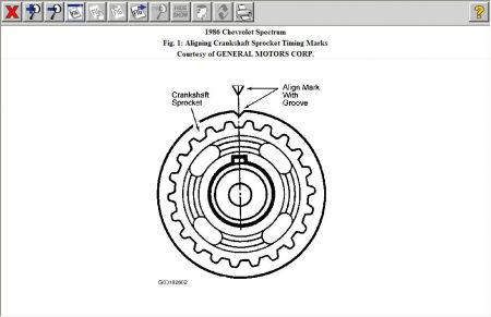

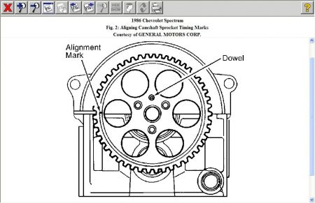

im trying to find out where im supposed to line up the cam gear marks. im replacing the timing belt any help would be great

Make sure that no.1 piston is on the compression stroke/TDC -line the markings cam and crank below before you put the belt on
https://images.2carpros.com/forum/automotive_pictures/12900_cam_9.jpg
https://images.2carpros.com/forum/automotive_pictures/12900_crank_3.jpg
