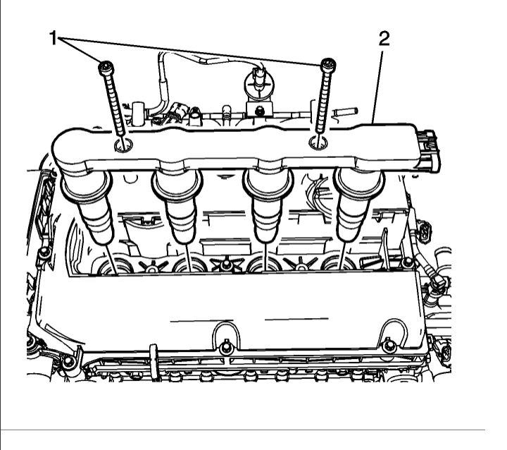

Hi, I would love to know how to get and change this cars spark plugs if it has.
Please assist.

Yes, you can change the spark plugs on your car using a spark plug socket. Below is a guide and some diagrams so you can get the job done and back on the road.
https://www.2carpros.com/articles/how-to-change-spark-plugs
Tighten the ignition coil bolts (1) to 8 Nm (70.8 lb in).
