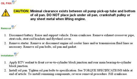

Is it possible to remove the oil pan while the engine is still in the car? Have anyone tried this on this make and model?
In most of my vintage cars this is usually possible.
If so I could clean the oil pan and even inspect some of the bearings.
Wednesday, August 29th, 2007 AT 1:23 AM
SERVICE WRITER
  • 9,123 POSTS
https://www.2carpros.com/forum/automotive_pictures/30961_oilpan_1.jpg
https://www.2carpros.com/forum/automotive_pictures/30961_mitchell_1.jpg
Wednesday, August 29th, 2007 AT 4:20 AM
  • 75,992 POSTS
This is what I've been trying to do since we got the software, but couldn't do it. Keep checking your inbox
