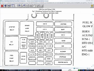

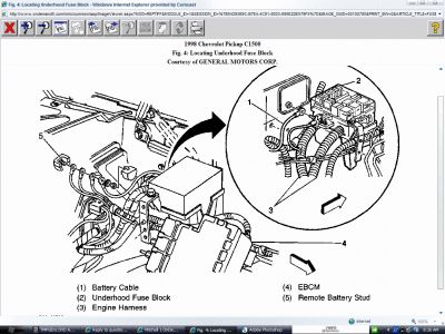

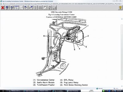

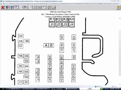

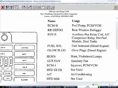

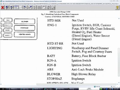

I have a 98 chevy silverado pickup with a v-8 350 motor 84,000 miles. the brake lights, turn signals and hazard lights stopped working. i have checked the fuse and replaced the flasher relay no help, also cleaned ground wire for tail lights. i unhooked the tail light plug to see if there was a short in them the turn signals on the front of truck still wouldn't work. is there a power distribution center or relay that provides power to this system and if so where is it located? Thanks for your help, :) bass man

Check fuse #1 inside and, check left rear side of the engine compartment for the underhood block...Legends included![ Also check the stop light switch on the brake pedal May bee out of adjustment or NG...push it inn all the way, then pull up on the brake pedal, check operation of brake light!img]https://images.2carpros.com/forum/automotive_pictures/62217_Fuse_Block_1.jpg[/img]
