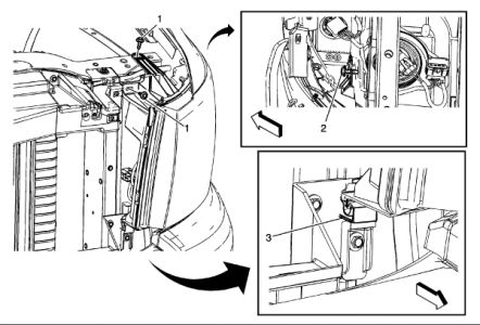

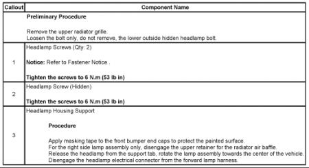

I am trying to remove the headlights on my 2008 chevy...unfortunately after removing the top two screws, i couldn't figure out how to get the light out without taking the whole grill out. please advise
Nov 14, 2008 at 10:28 AM
IMPALASS
  • 3,112 POSTS
Hello - I have attached information for a 1500, 5.3L truck. If this is not your vehicle then please get back with me and provide the specifics. Is it a 1500, 2500 etc. Also, the exact engine size in Liters. Next, the 8th digit of your VIN
