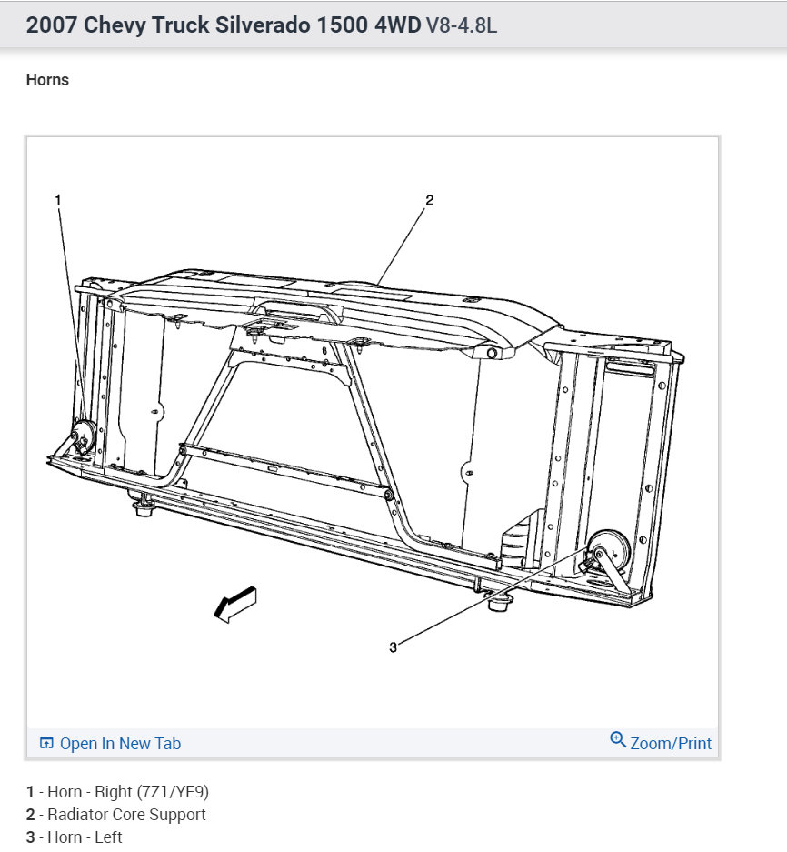

where is it located? Please help me.

Each of the horns (2) are on either side of the front core support. Check out the diagrams (Below). Please let us know if you need anything else to get the problem fixed.

Where is the horn located in a 2002 chevy silverado 1500?

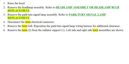

If your saying the horn doesn't work, the problem is usually in the steering column. I'd check fuses and everything before removing horn. They are located, left and right radiator support. Not sure how easy they are to get at?
