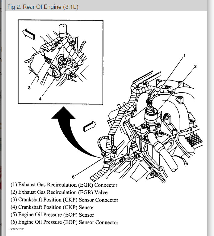

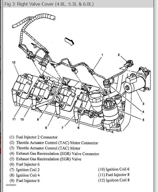

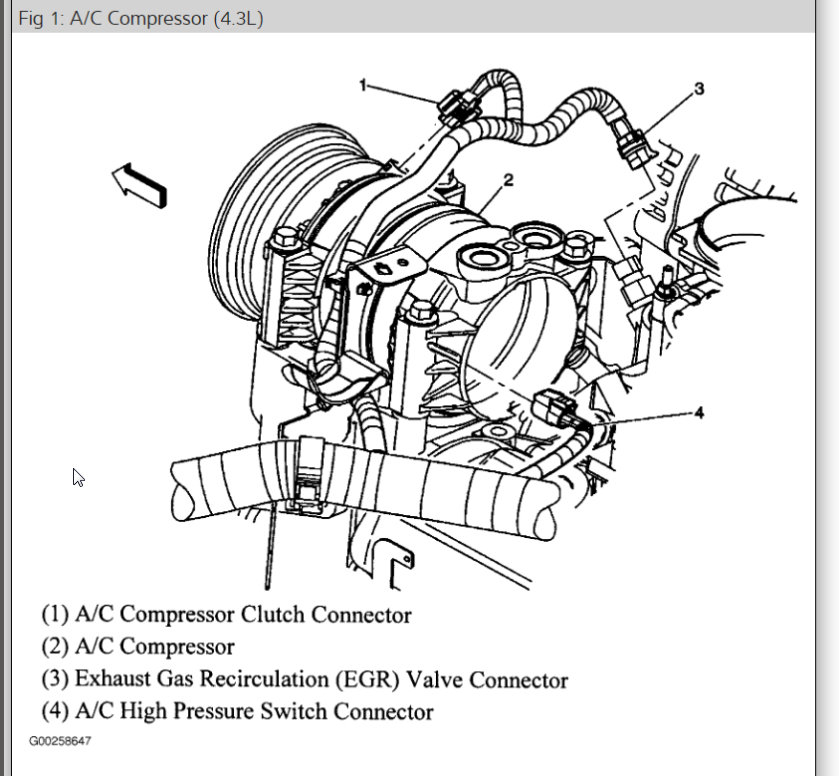

engine light came on - had it checked and was told it was egr code. owners manual says to check fuel cap for closure and possibly fuel. had recently filled up, so have not been able to try another fuel yet. fuel filter has 80% life as per computer reading. what do I need to do to address this code warning?
Jul 27, 2010 at 7:06 AM
A loose gas cap is not going to set an EGR code so more than likely you have an issue with the EGR. I would remove it and inspect it and if it were me, I would just replace it.
Here is a guide that will with testing it if you would like to do this:
https://www.youtube.com/watch?v=DqUCbbKdWf4
Below is the info for the EGR from the manual. Let's run through this info and let us know if you have other questions. Thanks
