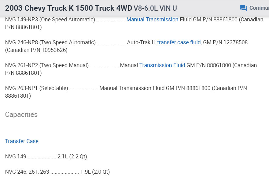

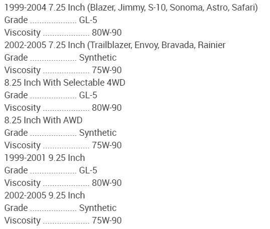

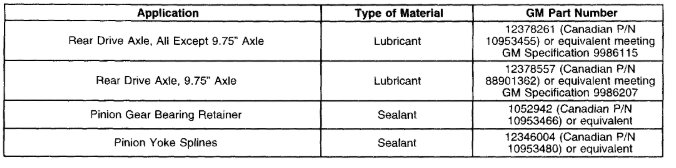

DANNY L
  • 5,648 POSTS
Hello, I'm Danny.
Changing with that mileage will not cause any harm.The most crucial is always an automatic transmission.Here is a tutorial showing how to change the differential fluid:
https://www.2carpros.com/articles/differential-service
I've attached pictures below showing what types of fluid and the capacities for the front differential,rear differential, and transfer case.Hope this helps and thanks for using 2CarPros.

ROBERTBARNES62
  • 83 POSTS
Just want to make sure I am getting the right stuff and amounts
for the front differential i need use 80w-90(how many quarts) and for the rear differential i need use 75w-90 synthetic(how many quarts) and for the transfer case I need to use auto trak II(2 quarts)
Can I use 75w-90 synthetic in both the front and rear? If I have to use 80w-90 for the front differential does it matter if ti says limited slip on the bottle? and for the transfer case if I can not find the auto trak II fluid can I use something else?
Oct 19, 2020 at 5:55 AM (Merged)

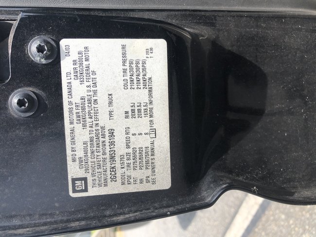

ROBERTBARNES62
  • 83 POSTS
2GCEK19N531361849.

DANNY L
  • 5,648 POSTS
Hello again.
As far as the transfer case goes it shows to only use the GM brand fluid which for whatever reason is called manual transmission fluid and calls for 2.1 liters. Both the front and rear differentials call for 75-90 weight limited slip gear oil.The front holds 2.0 qts and the rear holds 3.0 qts.You can use any brand for that.Hope this helps and thanks again for using 2CarPros.
