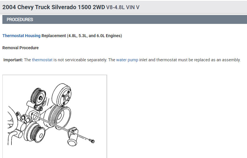

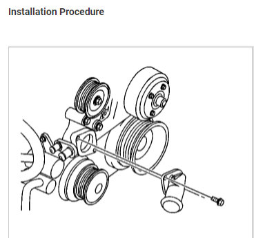

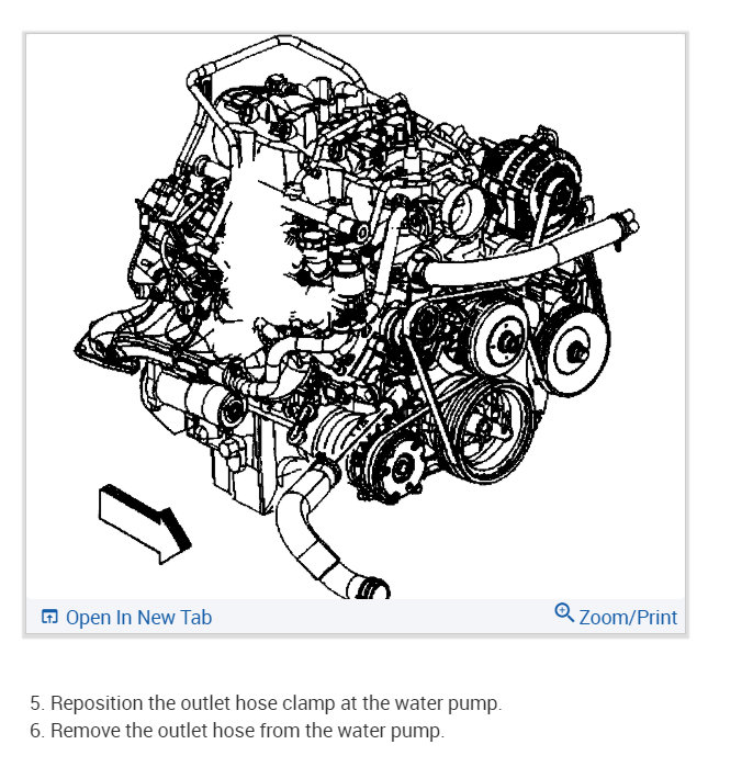

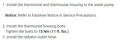

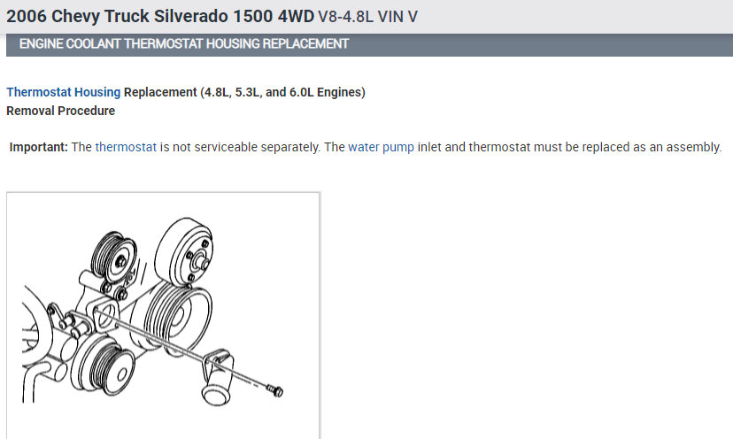

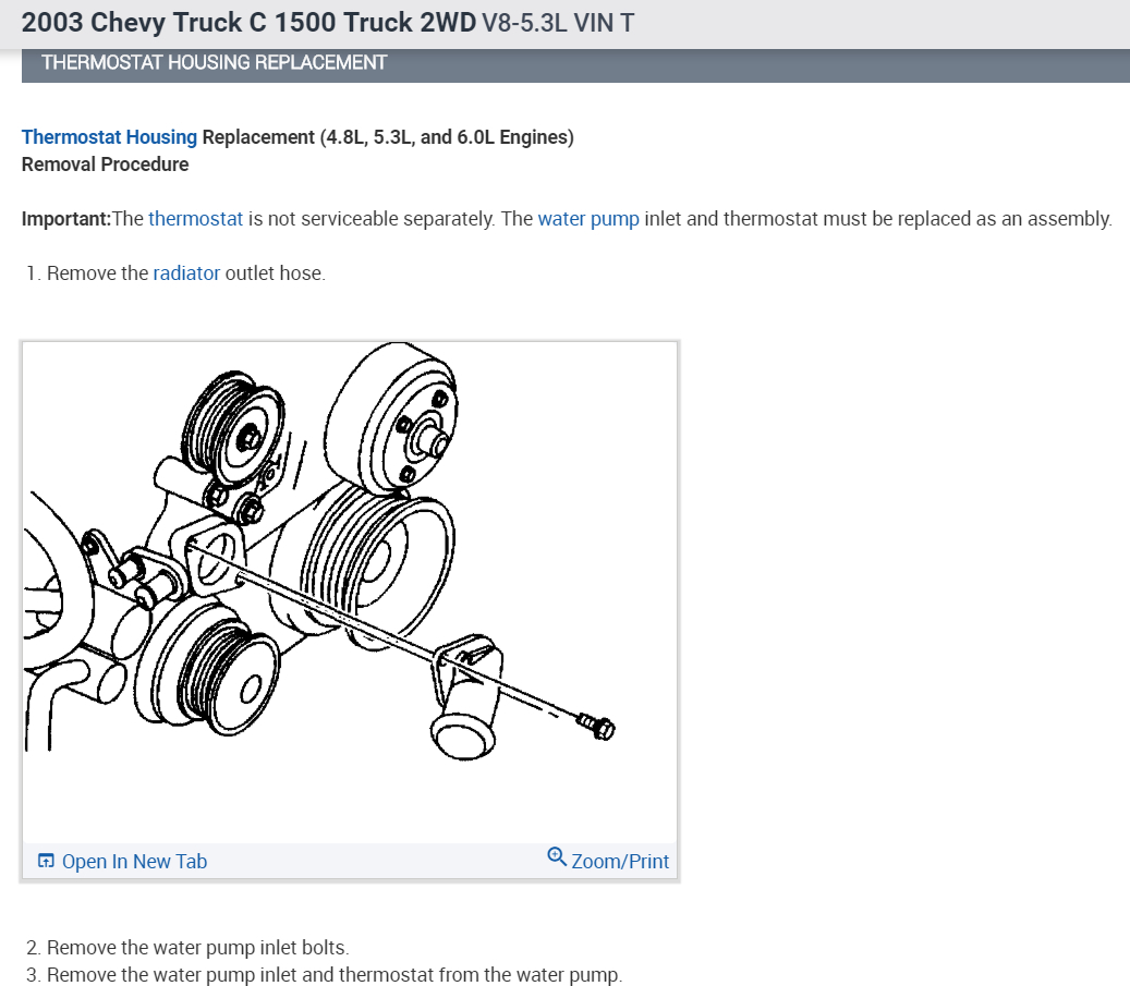

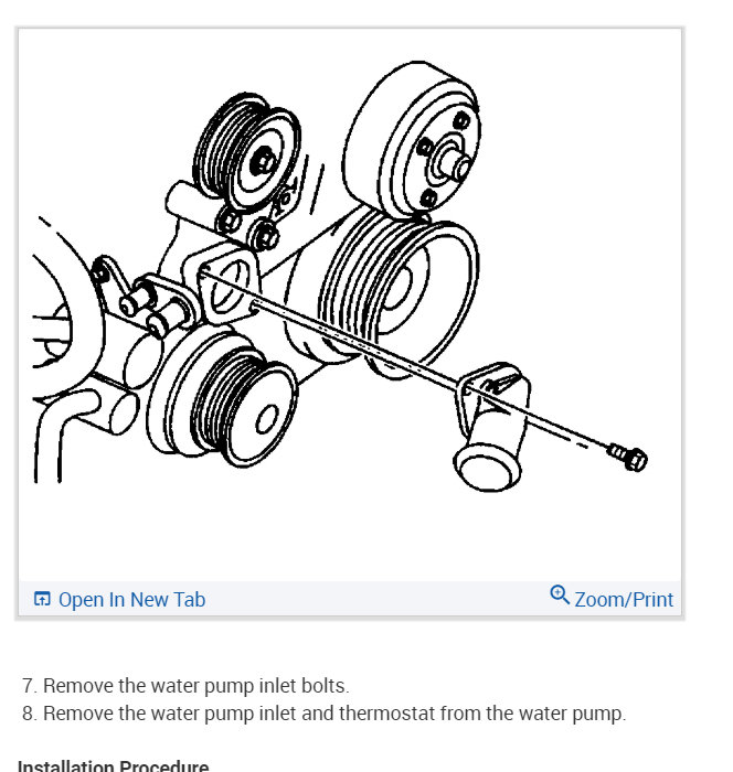

my thermostat is stuck but I cant find it to replace it can you help me please?
Aug 9, 2010 at 11:18 AM
DANNY L
  • 5,648 POSTS
Hello, I'm Danny.
Here is the information you requested. Here are a few tutorials for you to view on how to replace a thermostat and how to drain and refill the system before and after the repair:
https://www.2carpros.com/articles/coolant-flush-and-refill-all-cars
I've attached picture steps below showing how to replace the thermostat and its location on your truck. Hope this helps and thanks for using 2CarPros.

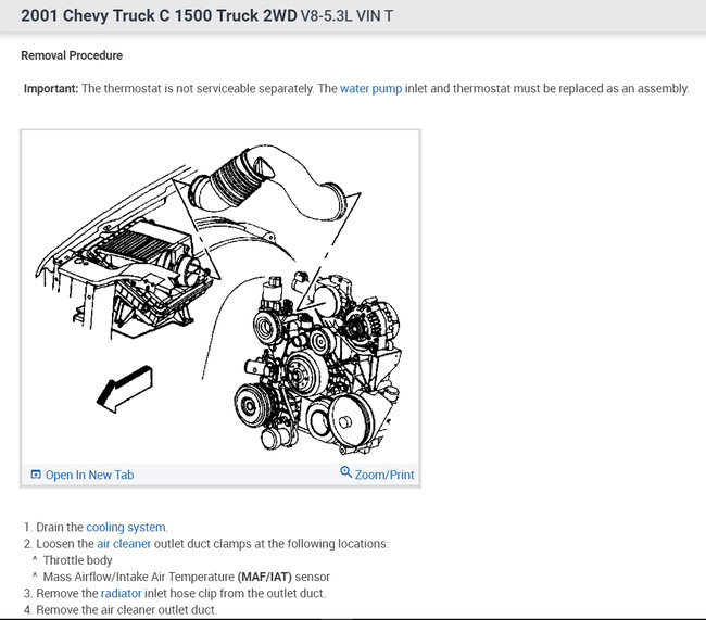

Jun 30, 2021 at 12:19 AM
WDIEDRICK

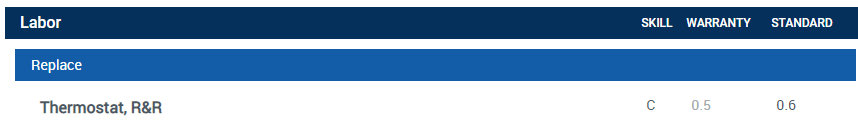

=How difficult is this task? I have not located it's location as yet however I expect it is where the radiator hose connects to the top of the water pump. Do you know how long it would take a trained technician? The engine temp is fluctuating during warm-up in cold weather.
Jul 8, 2021 at 9:26 AM (Merged)

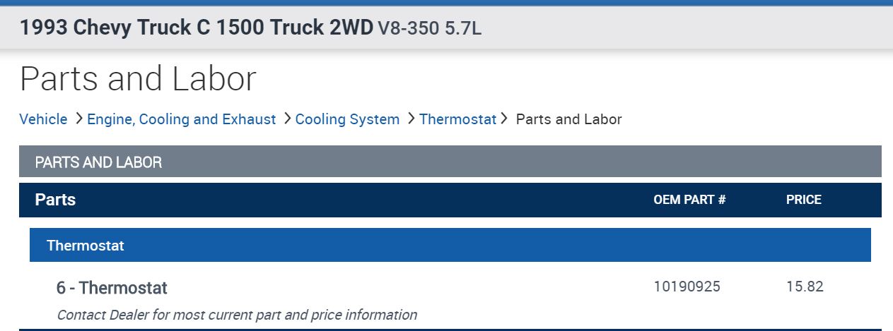

DANNY L
  • 5,648 POSTS
Hello, I'm Danny.
I've attached picture steps below showing how to replace the thermostat and its location on your truck. I've also attached a picture showing how long the labor would take from a Chevrolet dealership. Hope this helps and thanks for using 2CarPros.

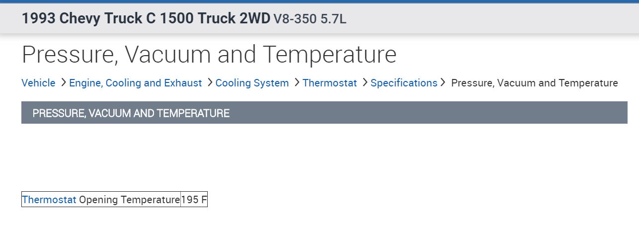

Coolant is fine. Thermostat has been changed. Temperature gauge had been running 160 but it runs around 200 if I run A/C, turn A/C off it will go back to around 160 but takes awhile. Have any suggestions? Thanks Carla

CARLA REED
  • 27 POSTS
No I did not replace it with GM12571281, I replaced it with Murray temperature control plus 37987. It hasn't gotten to quite 210. Should've ask you what's normal running temperature range?

SCGRANTURISMO
  • 4,897 POSTS
In the diagrams down below I have included the specifications for your vehicle's thermostat.

where is the thermostat on 1500 5.3 engine?
TAMZME
The thermostat is at the water pump housing here is a guide to walk you through to steps of replacing it and diagrams and instructions on how to do the job on your truck below.

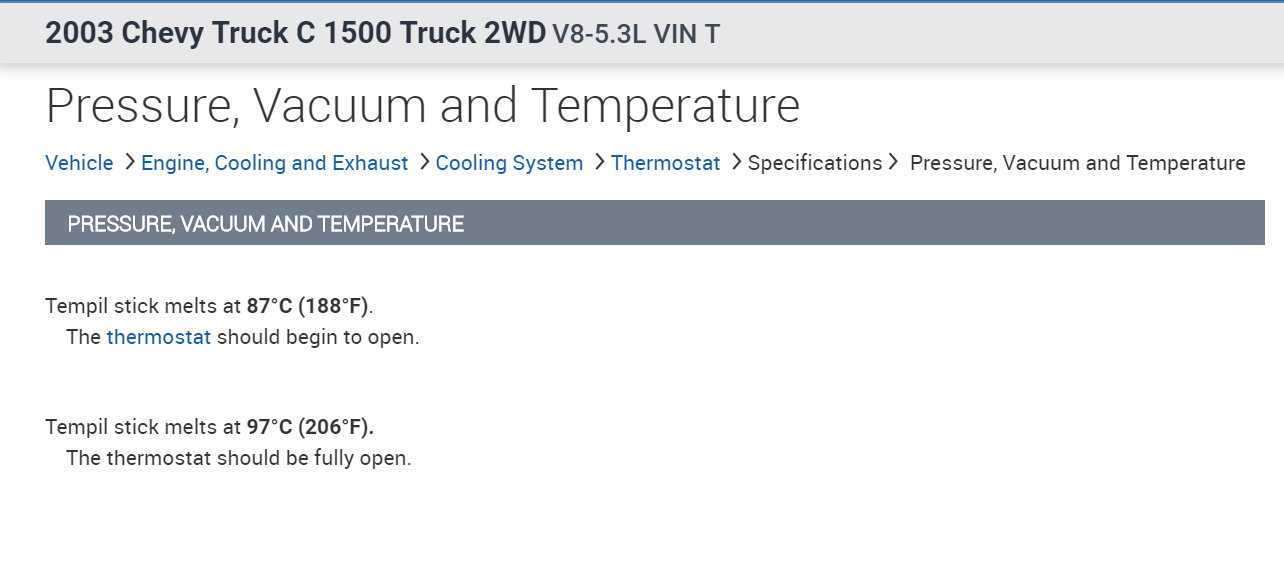

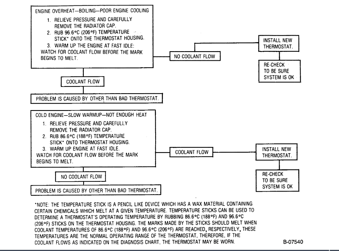

DAVIDULT20
I just got new water pump, fan clutch, radiator, and thermostat. When i first start it up and drive it, it heats up to 260 after like fifteen minutes, after it reaches the 260 is when the thermostat opens and cools down to about 210 and stays around there was wondering what it could be works fine after the thermostat opens. What could cause the thermostat to open so late?
Jul 8, 2021 at 9:27 AM (Merged)
SCGRANTURISMO
  • 4,897 POSTS
That is a tough one. Adding coolant to your water in the cooling system raises the boiling point of the water to around 250 degrees, so maybe too much coolant. It does sound like the wrong thermostat might have been installed. In the diagrams down below I have included the Original Equipment Manufacturer(OEM) thermostat part number, the correct thermostat opening temperature, and a thermostat diagnostic troubleshooting flowchart for you to go through. Please get back to us with what you are able to find out.
Thanks,
Alex
2CarPros

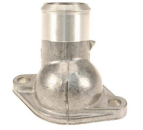

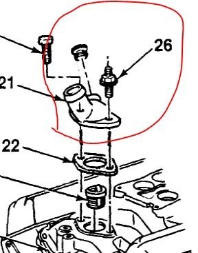

ROGER GOMEZ
I broke some plastic tube connection on the thermostat housing on the truck listed above Z-71 and cannot find a replacement housing.
  • 110,194 POSTS
Welcome to 2CarPros.
I have attached two pictures. The first is an exploded view of the thermostat housing on your vehicle. The second is a new housing available at any parts store that is a direct fit. Take a look at these pictures and tell me what has actually broken. Also, if you could upload a picture of the broken part, it would help.
Let me know,
