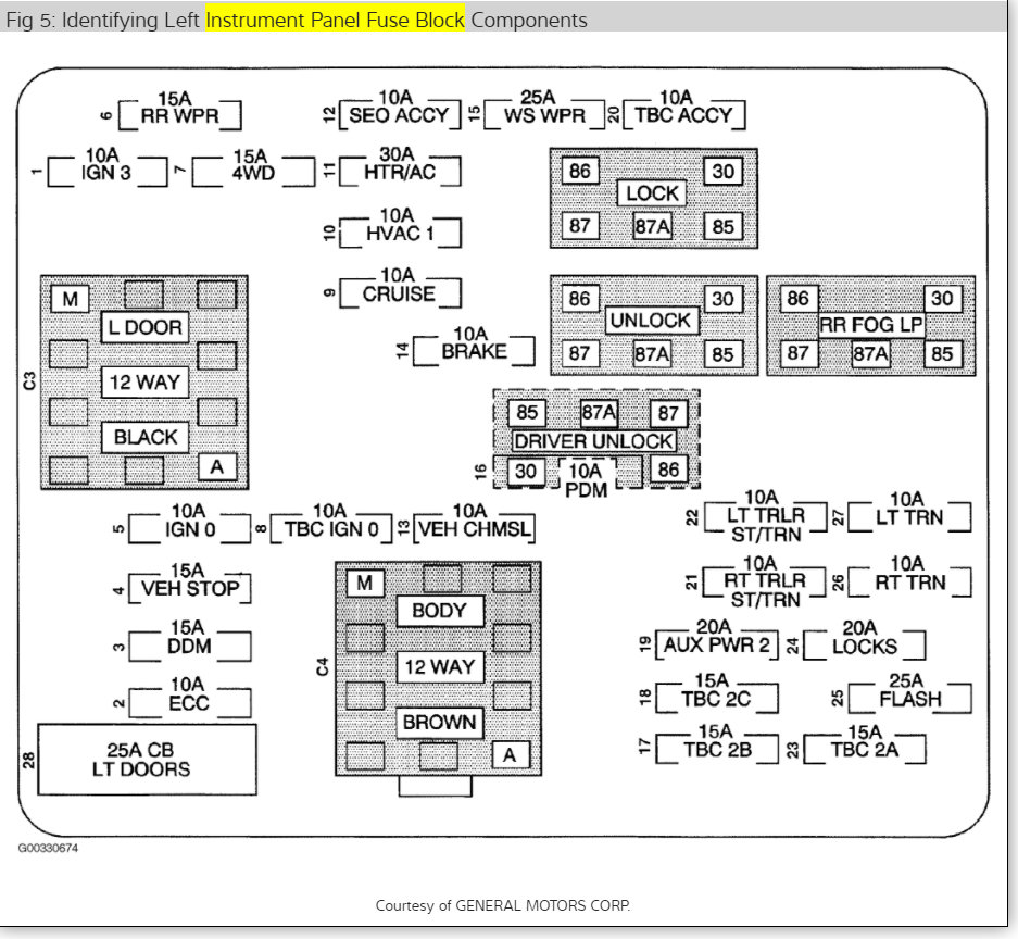

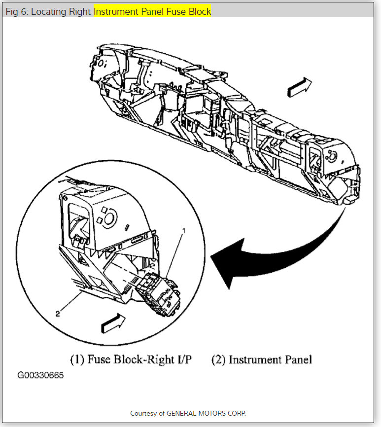

Check the accessory power outlet fuse labeled AUX PWR (a 20 amp fuse in the fuse box under the hood) here is a guide and the location of the fuse..
