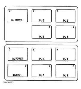

How do i locate the fuel injector relay on my 2005 chevy silverado truck? I cant seem to locate it.

you have 9 relays , one main injector relay and 8 separate injector relays, all grouped together at the left rear of engine compartment.
