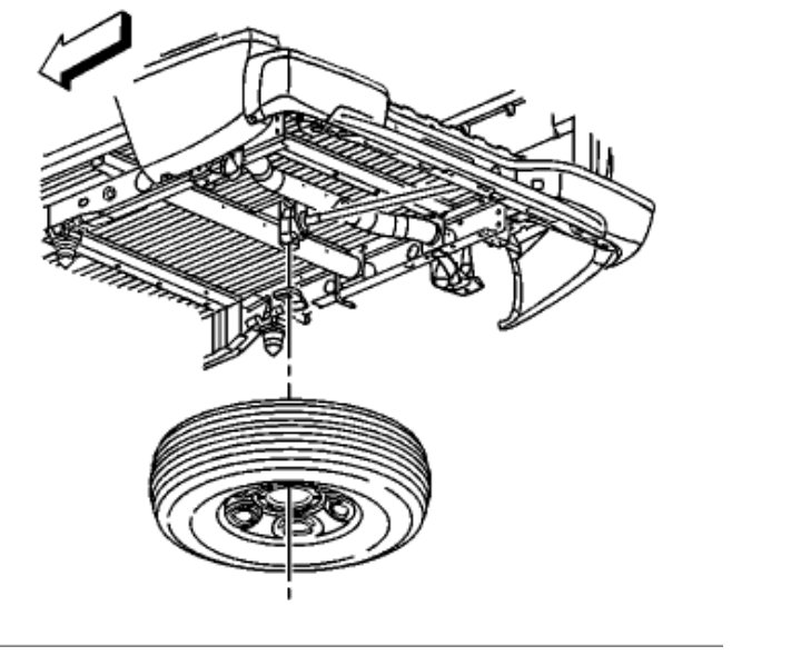

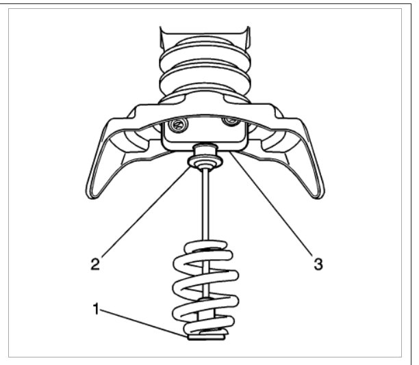

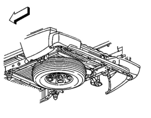

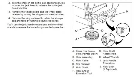

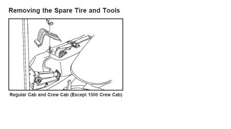

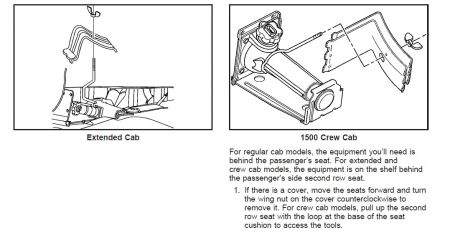

How does my jack and related tools go back into the truck?
Saturday, July 24th, 2010 AT 11:24 AM
JDL
MECHANIC
16,098 POSTS
The jack is located under the back seat check the diagrams below as well
https://www.2carpros.com/articles/flat-tire-change-it-easily-by-watching-the-pros
Here is how you can take down the spare tire as well Check out the diagrams (Below) Please let us know if you need anything else to get the problem fixed.
