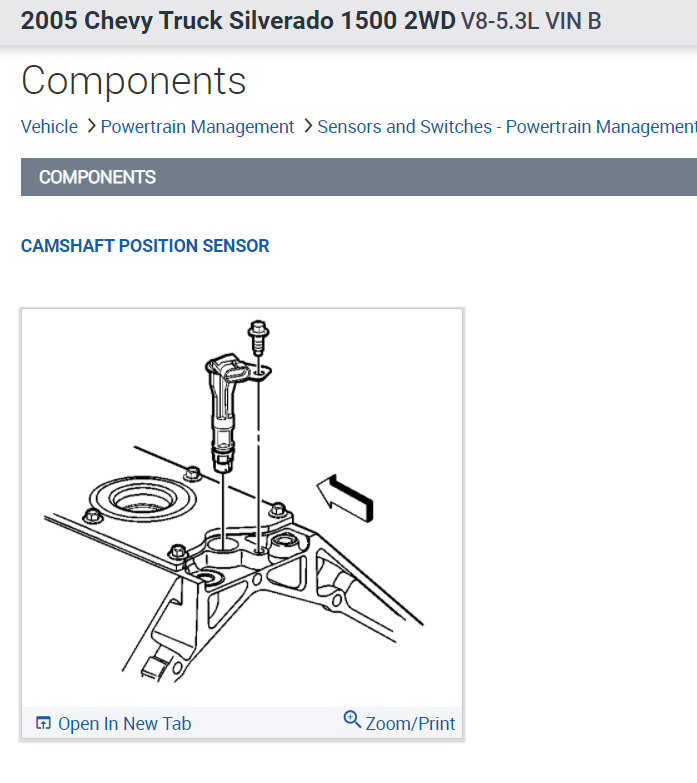

I am having trouble starting my truck. Finally logged a P0342 code calling out cam sensor. Where is it located and how do I replace it? Can I test it beofre buying the new part? Ohm test?
Jan 25, 2010 at 9:46 AM
SCOTTY DEE
  • 592 POSTS

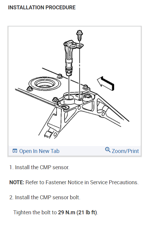

You are going to need a scan tool to read parameter identification. Also will need to disconnect the sensor a verify 12 volt reference. If there are no short to grounds, or other wiring issues and no debris between the sensor and the reluctor ring, you could have a bad CMP sensor or in the worst case a bad PCM. The sensor is located behind the #2 knock sensor on top of the lower plenum.Here is the location of the camshaft sensor in the diagrams below. Check out the diagrams (Below). Please let us know what happens.

that was confusing but I got a new sensor the truck starts, it runs great. Thank you
