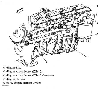

my check engine light went on because of my knock sensor. if i want to replace it myself how do i do it.

Engine knock sensor is located at lower left side of engine, pictured below.. Remove any necessary components to gain access to sensor. Disconnect sensor electrical connections and remove any securing bolts/brackets from sensor. Remove sensor and replace with new one.
