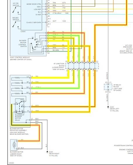

5 high speed quit working about a month ago, now fourth has quit. so I read up and replaced the resistor and wiring harness, and the 1-4 works fine but still no fifth. Read up and checked and changed the 40 fuse under hood, then fifth worked but not 1-4. Unplugged the fuse all together and 1-4 work and no 5, rep lug in fuse and only fifth works? Any help would be appreciated!

I attached a diagram for you to view.
The blower switch provides power to the blower resistor in 1-4. 5 is a direct bypass from the blower switch to the resistor and to the blower motor.
What brand resistor did you use?

Duralast, from AutoZone.
Apr 28, 2021 at 12:22 PM
What harness did you replace?
DAVID TOWNSEND2
The 6 wire junction box.
DAVID TOWNSEND2
A couple of the terminals looked as if they had gotten a little hot.
Okay, are you sure you put the wires in the correct location on the pigtail?
I would also get a GM resistor as well. Some of the aftermarkets do not meet the quality standards of the original.

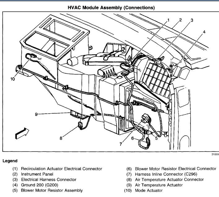

Quick question first. Was the interior submerged with water? If not a common problem with these trucks are the blower motor resistor. It's mounted on the HVAC box next to the blower motor. I've attached a picture below of its location (#5). They have had a problem melting/poor connection/loose wires. Hope this helps and thanks for using 2CarPros.

The problem you are descibing is a failed blower motor resistor. This is located under the passanger side dash next to the blower motor. It is a pretty easy fix. Couple of screws and one connector. Note the connector goes to the blower motor for location identification.

The resistor assembly is under passenger side of dash, number 5 in the picture.
