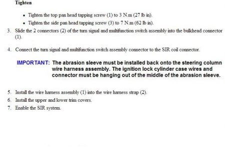

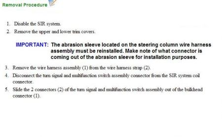

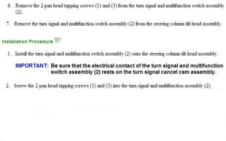

I am looking for instructions on replacing the turn signal switch

Jul 27, 2009 at 2:37 PM
