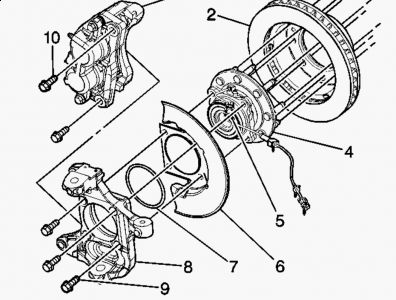

How do i go about replacing the outer bearings and inters to .

Remove the brake caliper, rotor, and axle nut remove the bolts holding the hub bearing to the hub, remove the bearing, it's a one piece brearing & hub. #4 in the diagram, #5 ids the wheel speed sensor, be carefull with it! Torque the axle nut to 177-180 FT Lbs.
