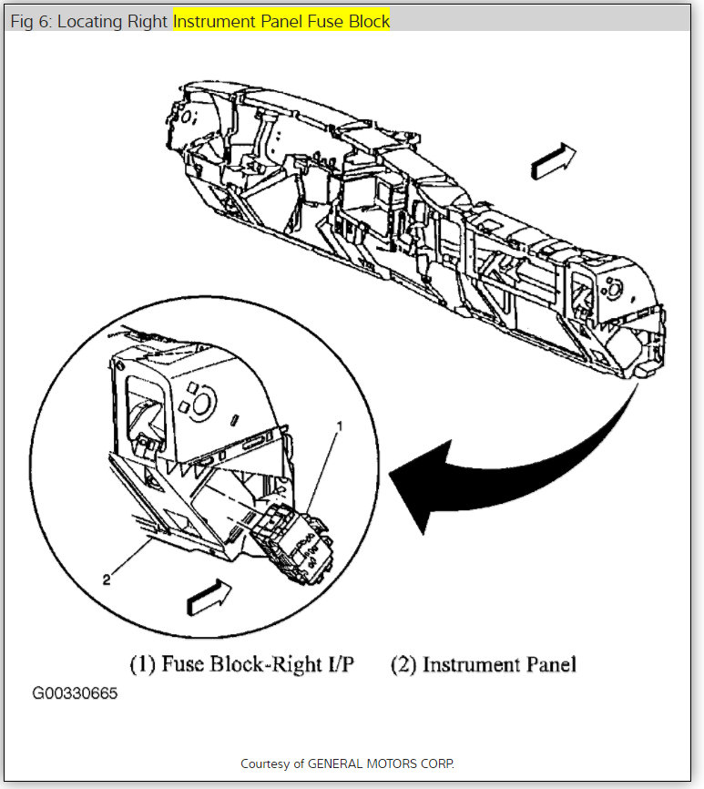

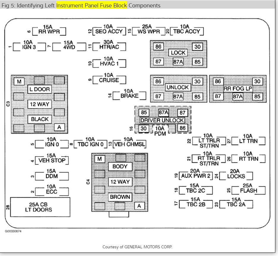

So when you put test light in series with batt term and batt it lights? if yes you got a big drain. If all is so try disconnecting the B+ to alt. Light goes out then alt diodes out defective. Here are eht fuse panels in the diagrams below.
