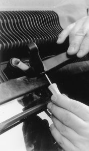

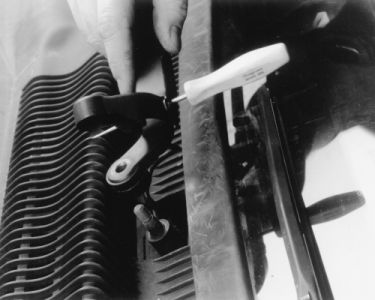

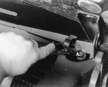

I have ordered a wiper module due to wipers will not turn off. My question is, is there a clip on the wiper bar that releases the wiper from the threaded shaft after the nut has been removed? I have removed the securing nut, but cannot remove the bar to get access to the wiper motor enclosure.

Remove the wiper arm mounting nut, then
https://images.2carpros.com/forum/automotive_pictures/52960_0900c152801cb5b0_1.jpg
while holding the wiper arm up, insert a slim tool into the hole near the hinge
https://images.2carpros.com/forum/automotive_pictures/52960_0900c152801cb5b1_1.jpg
and lift the wiper arm off of the mounting stud-arm attaching nut type
https://images.2carpros.com/forum/automotive_pictures/52960_0900c152801cb5b2_1.jpg
