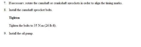

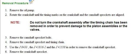

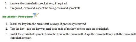

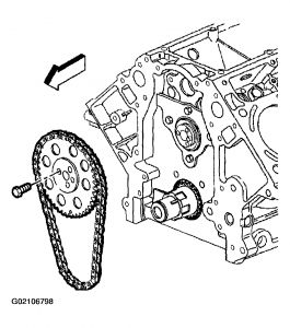

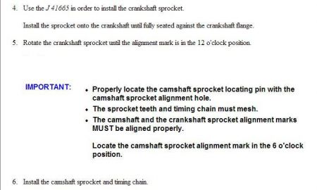

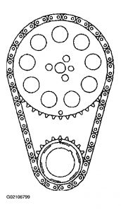

how do you replace the timing chain and gears? It is a 6.0 vortec gasoline engine
Feb 9, 2010 at 1:47 PM
BLUELIGHTNIN6
  • 16,542 POSTS
https://images.2carpros.com/forum/automotive_pictures/261618_Noname_1621.jpg
https://images.2carpros.com/forum/automotive_pictures/261618_Noname2_496.jpg
https://images.2carpros.com/forum/automotive_pictures/261618_Noname3_190.jpg
https://images.2carpros.com/forum/automotive_pictures/261618_Noname4_93.jpg
https://images.2carpros.com/forum/automotive_pictures/261618_Graphic_318.jpg
https://images.2carpros.com/forum/automotive_pictures/261618_Graphic2_46.jpg
