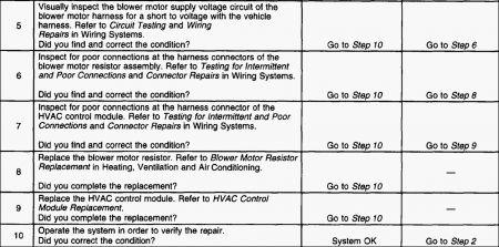

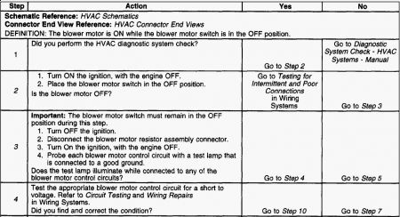

Here's the repair flow chart, use a test light as described.
If this dosent help, get the truck scanned for codes, you need a GM campatible scanner to read B and U codes, generic scanners wont work for this.
