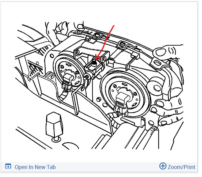

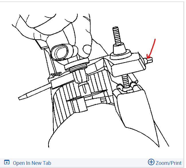

how to adjust headlights up and down?
Dec 30, 2008 at 3:08 AM
GFIMOTORCARS
  • 673 POSTS

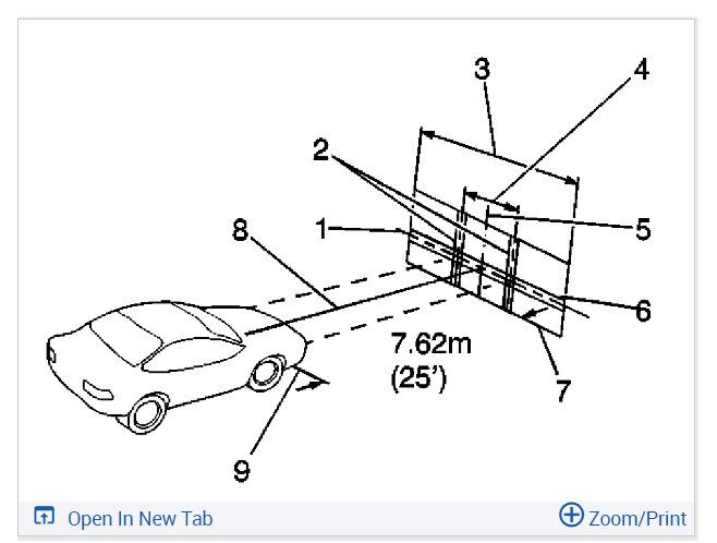

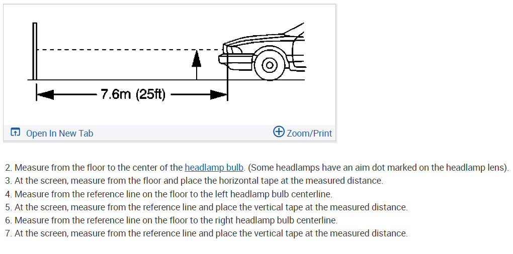

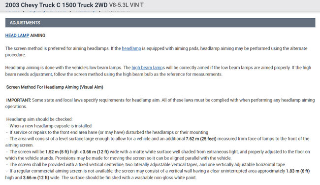

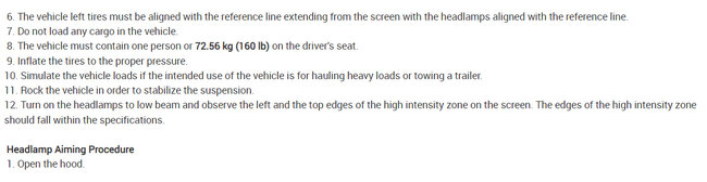

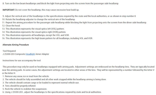

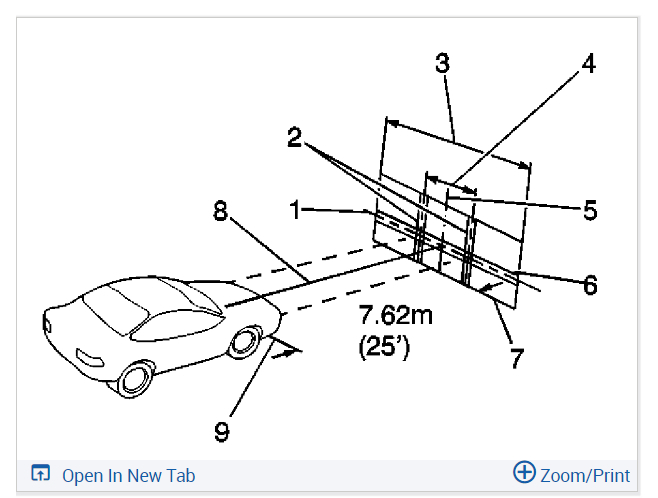

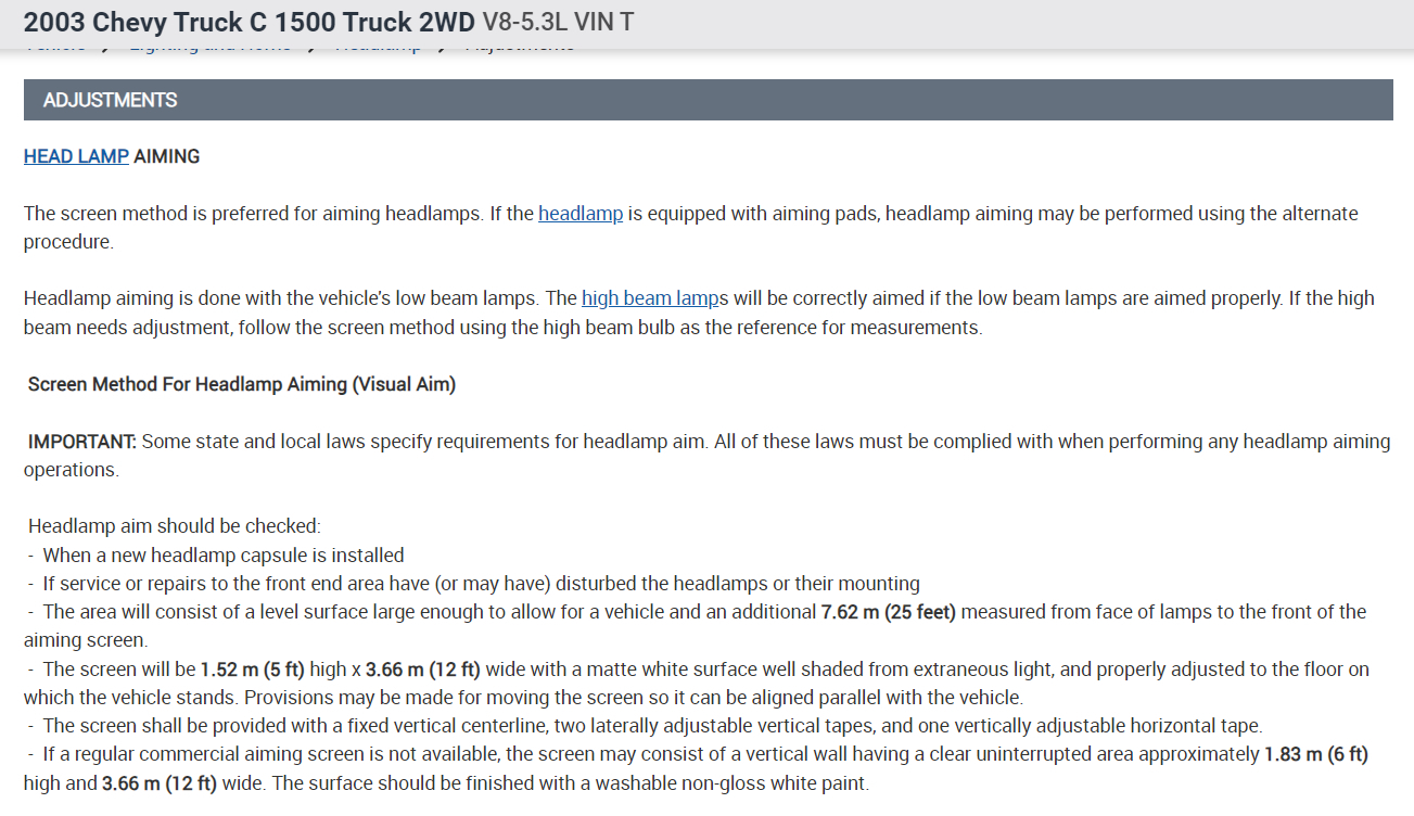

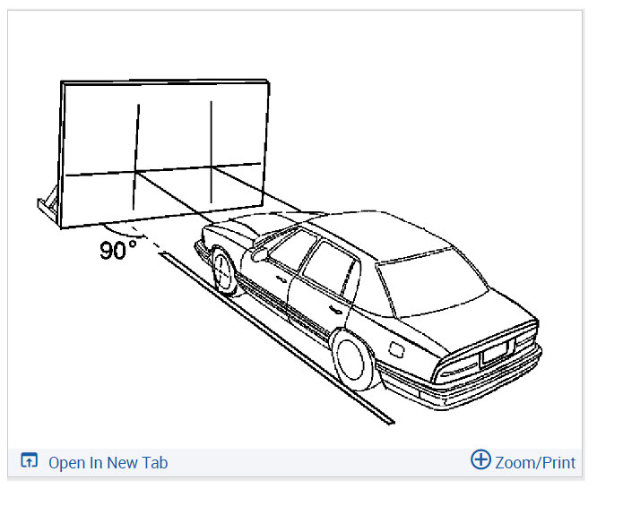

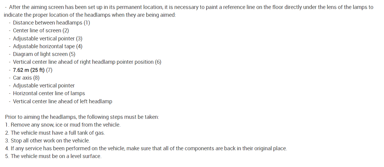

Open your hood and look over the headlight area. You will see two, one to the inside of the assembly and one to the outside, Torx screws size 15 (screw with star shaped head) These two screws are your adjustments. The one to the outside of the vehicle is your up/down adjustment. The inside is your right/left. Please check out the images below for more instructions on how to adjust the headlamps. Check out the images (below). Let us know if you need anything else.
