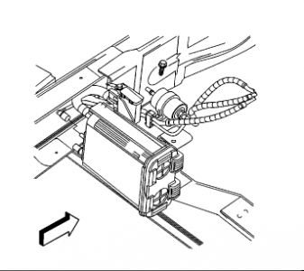

its not really that hard, you dont have to remove the bed to check or replace the vent solenoid or canister,for the canister just pull the plastic lines off and see if gas pours out,if it does then replace the canister,if they get filled with gas from overfilling the tank,the gas tank get vapor locked causing a slow or no fill condition,as far as the vent solenoid there is no real way to test it,you need a scan tool to command it off/on to see if it clicks,if it dosent they it need to be replaced.
https://images.2carpros.com/forum/automotive_pictures/147643_canister_2.jpg
this is the canister
