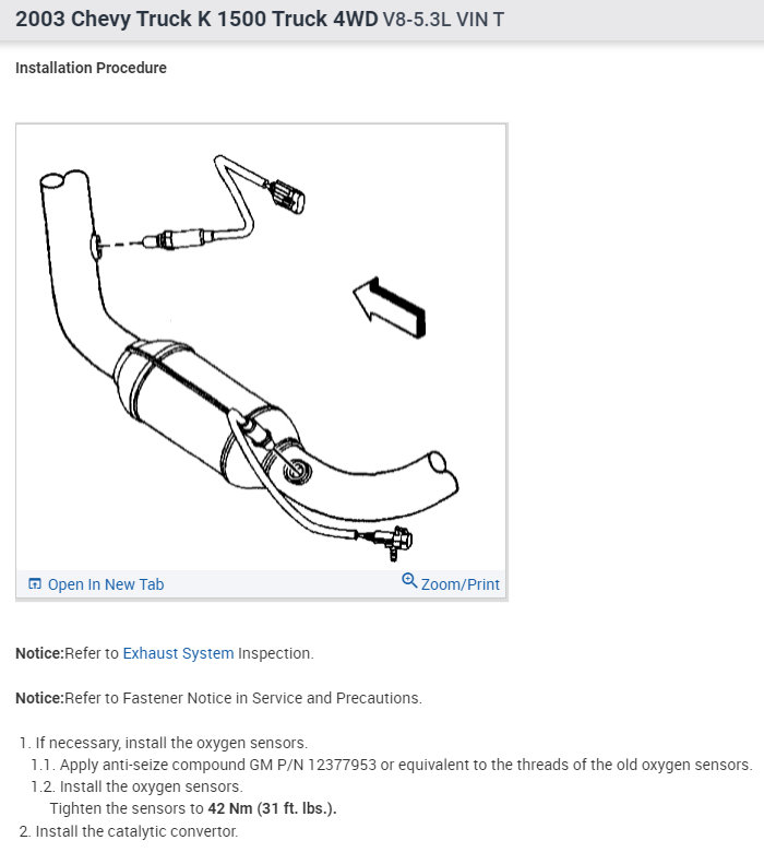

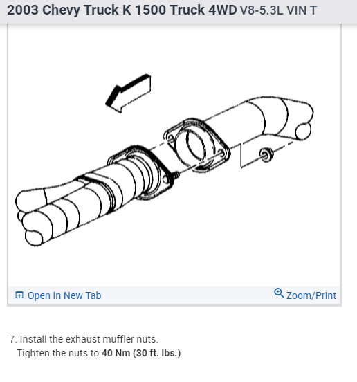

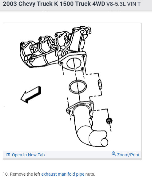

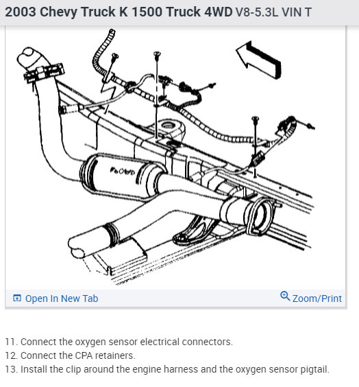

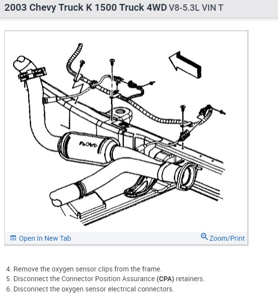

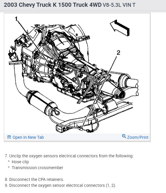

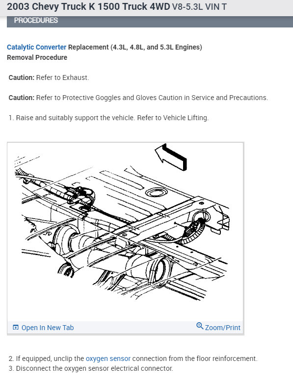

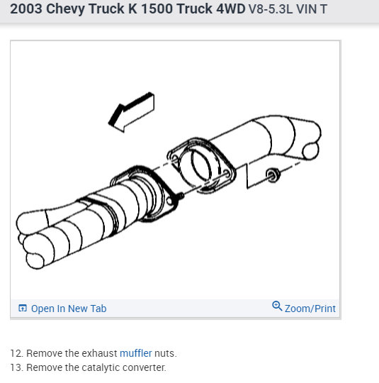

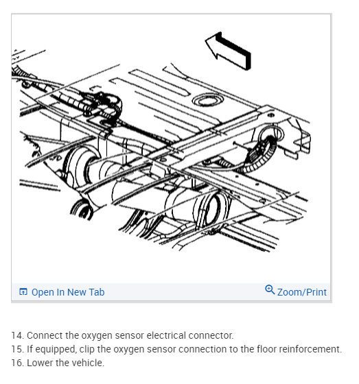

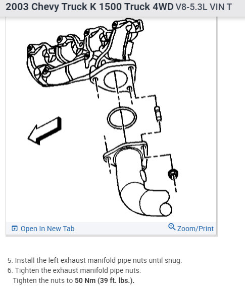

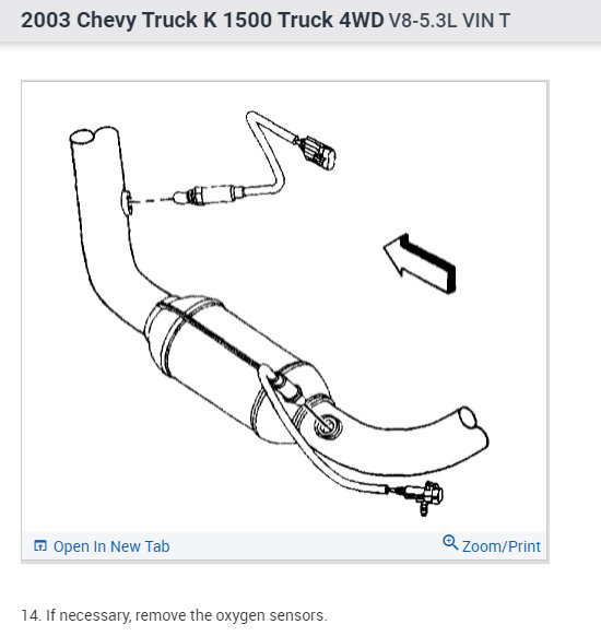

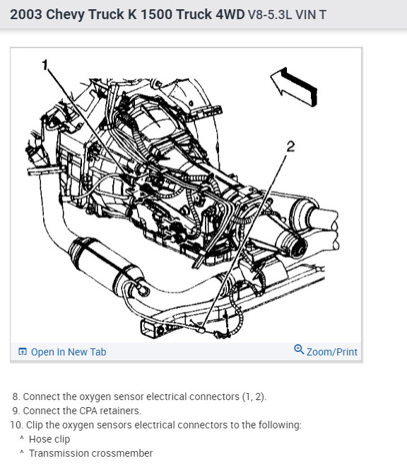

SQM
  • 6,383 POSTS

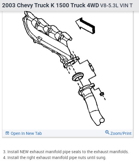

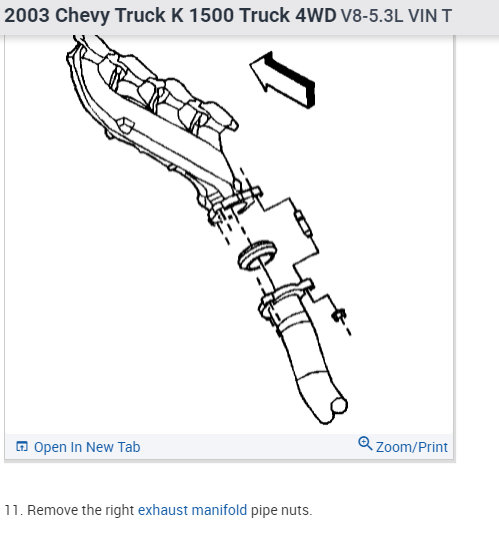

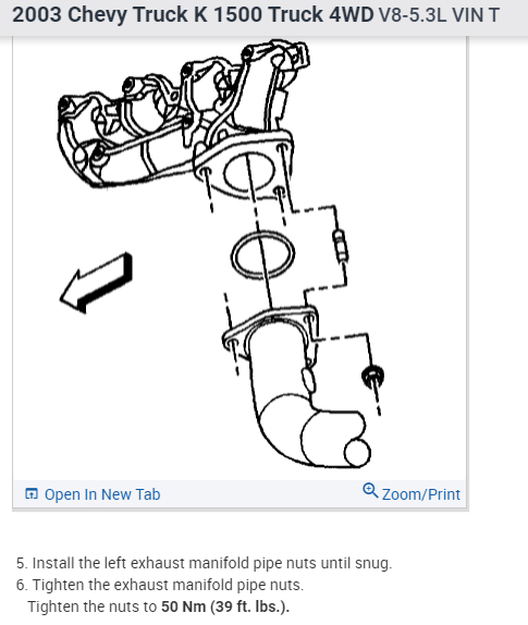

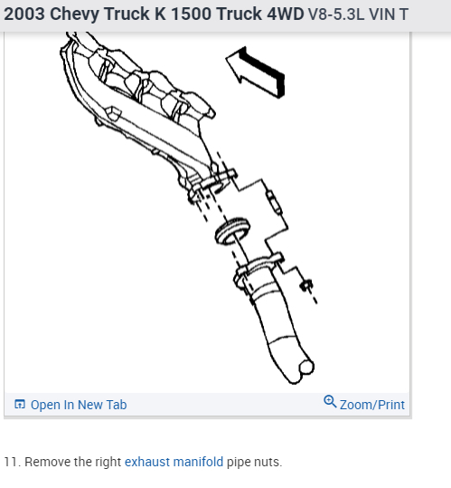

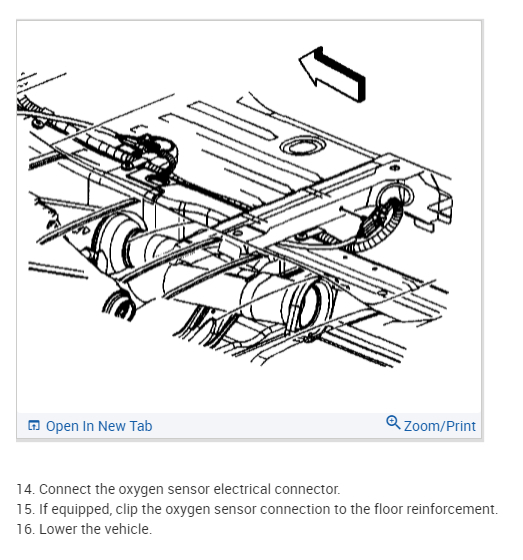

Thank you very much for sharing the information on the fix.
I have attached the catalytic converters replacement procedure below, for anyone who might be looking to replace them.
https://www.2carpros.com/articles/catalytic-converter-replacement
