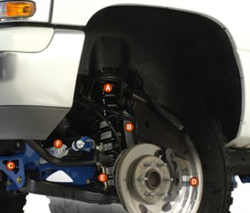

I RECENTLY BOUGHT A USED 2003 CHEVY SILVERADO 1500 EXT.CAB THAT WAS ALREADY LIFTED ( 4" TO 6" ) I WAS UNAWARE OF THE ROUGH RIDE, ESPECIALLY ON A DIRT ROAD. MY QUESTION IS CAN I DO SOMETHING TO SOFTEN THE RIDE LIKE CHANGE THE SHOCKS OR WOULD I NEED TO CHANGE THE SUSPENSION BACK TO STOCK, WHICH WOULD BE QUITE AN EXPENSE TO ME. THX.

Ok there shouldn't be front springs you should have a torsion bar front suspension and rear leaf. Now if is it making noise in the front then it may need adjusting. Is the front higher then the rear or the other way around? You will find that Fabtech changed the control arm so the front shock is not what it was stock either because of the lower mount. You shock should now look like the pic below? If so then you need to ask for a shock for an 04 1500 and I would go to a Rancho 5000 series shock it will ride better. Get back to me on my question above about the ride height.

Sorry it's 2 wheel drive so it is coils not torsion bars. So shocks should be like stock just lifted. In you previous response you said it was a noticable difference from front to rear so I figured it was unlevel. Depending on the lift you may be able to go back to stock if you wish or change out the front springs so that it rides like it should. Does your truck look like the pic included where you have all the new brackets (blue) as shown or not?

THE SUSPENSION IS VERY SIMILAR TO THE PIC YOU SENT, YES IT IS TWO WHEEL DRIVE. IM ASSUMING THAT I CAN TAKE IT BACK TO STOCK. DO YOU THINK I NEED ADJUSTMENT BECAUSE OF THE SOUND OF THE SPRINGS OVER EXTENSION, AND CHANGE SHOCKS FOR THE SMOOTHER RIDE?

Ok here is how they show there kits. Either 3 inch or 7 inch lifts for you truck. Now the 3 inch is a spindle lift so the kit is new spindles for the front new shocks all around and rear block kit with u-bolts and that is it. If that kit was used then yes you take it back to stock. However if you have all the brackets and such then you have a 7 inch lift so the kit comes as a very intense kit that comes with most everything you see in the previouse pic and more. You do some modifications and install. It is not going to go back stock as brackets have been removed to make room for the kit and all the drop brackets. I would check the shock. Othere then that there isn't much you can do.
