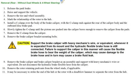

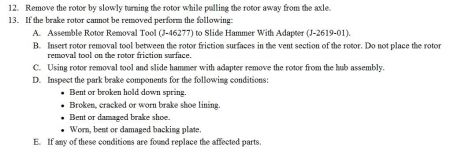

2003 Chevy Silverado V8 Four Wheel Drive Automatic
My rear brake rotor will not come off. Removed the emergency brkae cable, tapped the hub of the rotor. I still am having no luck removing the rotor.
