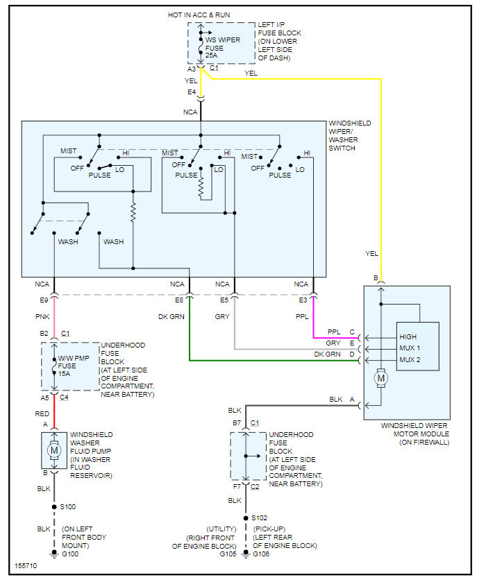

Wipers only work on hi speed. What do I need to replace???
Nov 6, 2009 at 5:09 AM

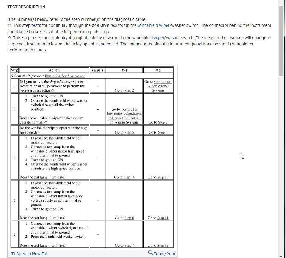

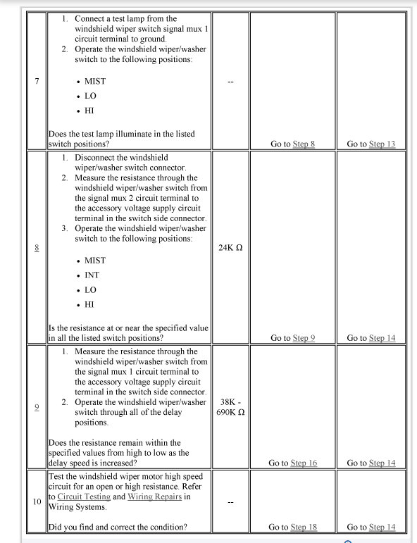

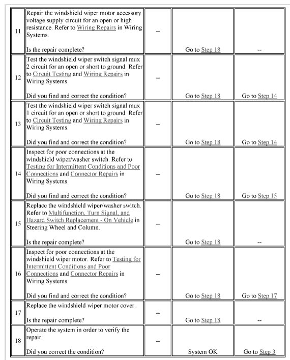

It is hard to know for sure what the issue is but most likely it is the switch. However, here is the testing that we need to run through to find out for sure.
Let us know what other info you need. Here are some guides that will help with this testing:
https://youtu.be/Hlna_kUt7As

The problem is the wiper board next to the wiper motor. It has a breaker for heavy snow and can blow and not reconnect which only allows high speed wipers.

Have a 98 with similar problems. It was caused by the connector plug to the drivers side wiper motor. When they go out wiggle the connector plug to see if they come back on. I ended up having connector plug replaced.

There is a windshield wiper module within the motor. It is a simple allen wrench repair. There are three small allens and the board comes out with the female plug end attached. Slide the new one in and you are done.
Dec 15, 2020 at 9:12 AM (Merged)
VETTEMAN2003
Thanks for your replies. Apparently on my 2002 Silverado, the control board is built into the plastic cover. When I removed the cover I saw no way to remove the board. I just today replaced the entire motor assembly, I got the whole thing on EBAY for the price of the cover alone. I am happy to say I have all speeds working now and all seems well. Sadly, as I was doing the work, I remembered I need a tune up, and can't even see the distributor cap, looks like major surgery just to replace the cap, don't ya just love these new vehicles. Thanks again, I really like this forum.
