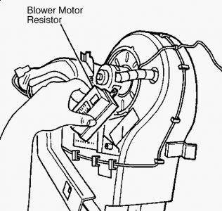

where is the resistor assembly located. how to replace i.e. remove center console or dash?

This is for manual system, auto temp(automatic) is different! BLOWER MOTOR RESISTOR Removal (Front) If equipped, remove the I/P sound insulator. Disconnect the electrical connection from the blower motor. Disconnect the electrical connection from the blower motor resistor. See Fig. 28 . Remove the blower motor resistor retaining screws. See Fig. 29 . Remove the blower motor resistor. See Fig. 30 . Fig. 28: Disconnecting Electrical Connector From Blower Motor & Blower Motor Resistor Courtesy of GENERAL MOTORS CORP. Fig. 29: Removing & Installing Blower Motor Resistor Retaining Screws Courtesy of GENERAL MOTORS CORP. Fig. 30: Removing & Installing Blower Motor Resistor Courtesy of GENERAL MOTORS CORP. Installation (Front) Install the blower motor resistor. See Fig. 30 . Install the blower motor resistor retaining screws. See Fig. 29 . Tighten to specification. See TORQUE SPECIFICATIONS . Connect the electrical connection to the blower motor resistor. Connect the electrical connection to the blower motor. See Fig. 28 . If equipped, install the I/P sound insulator. Page 1 of 1 3/14/2010 ...
