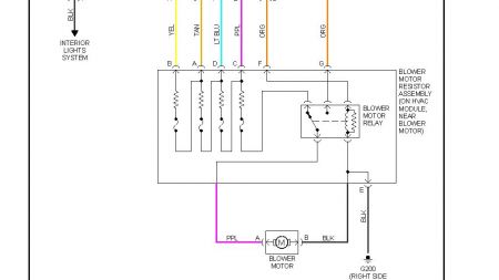

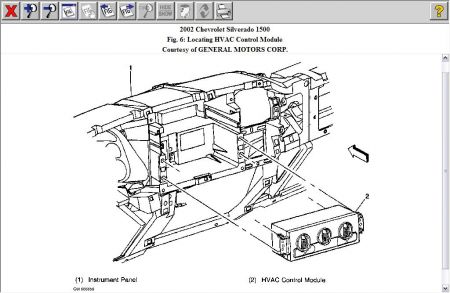

My fan switch only works in the 4th position is it the switch or the motor how do I test it?
Wednesday, December 5th, 2007 AT 11:44 PM
  • 75,992 POSTS
If it works only in 4th, you need to check the blower motor resistor is on the heating/ventilating/airconditioning module near blower motor.
The purple wire at blower motor should have battery voltage-if it does the blower motor is defective. If not backtrack it to the control switch see below.
