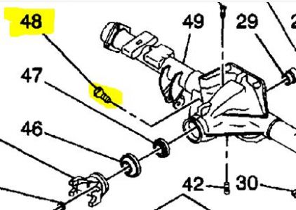

I'm looking to service my differential and I see the drain plug, but where is the fill plug?

Hi there, With out the exact diff type in your car i can't look at the correct pic, but i feel that they will all be the same in the car, check the pic the plug is quite small it may be coverd in mud and not visable.
