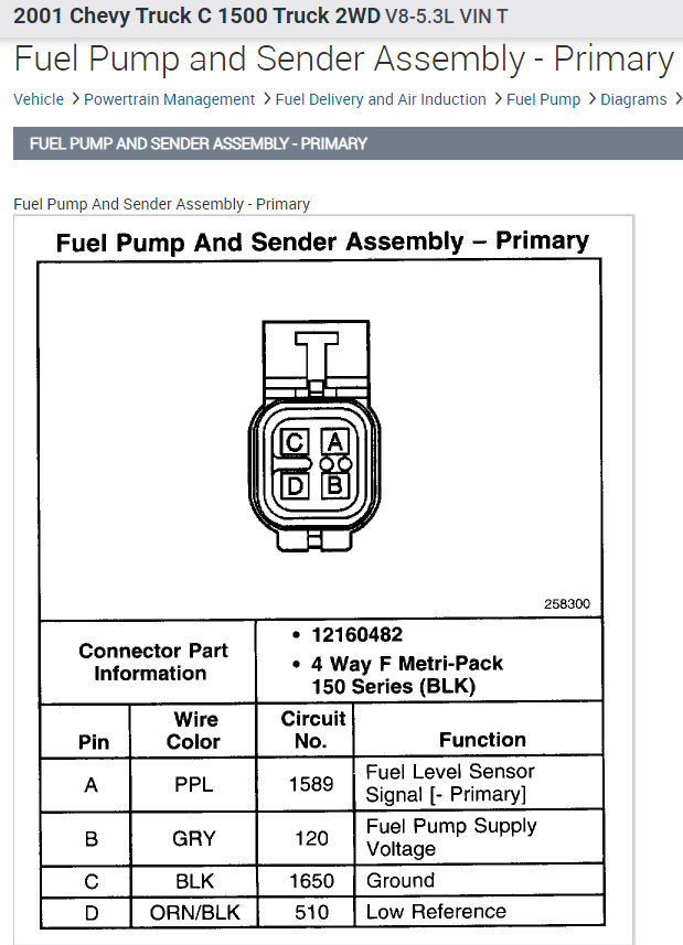

Does it crank when you turn the key?
Many times when a crank position sensor goes bad the vehicle will stall in a similar fashion.

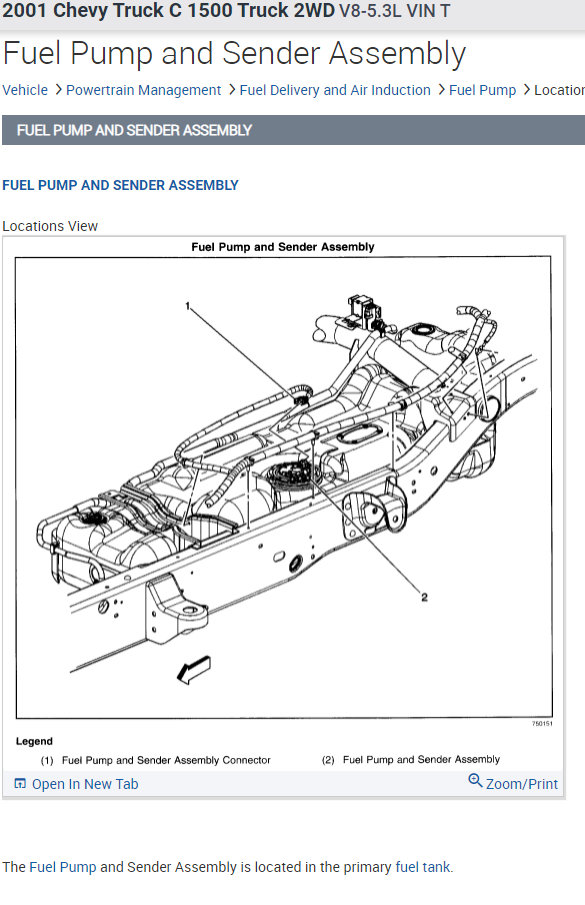

Can you hear the fuel pump come on?
You can check to see if you are correct amount of pressure.
You should have 55-62 PSI of fuel pressure.

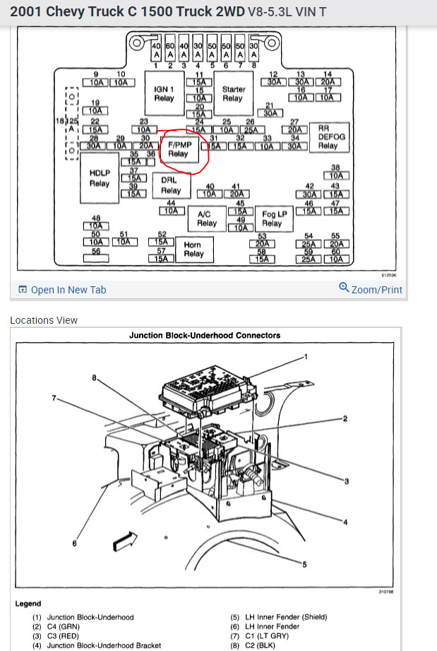

You also want to check the fuel pump relay.
That relay is located in the junction box under the hood (See diagram).
