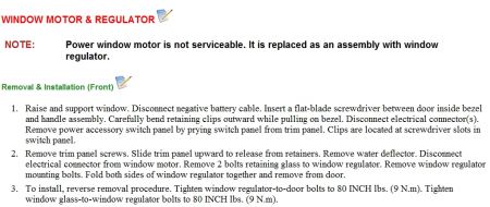

how do i replacel window regulator

https://images.2carpros.com/forum/automotive_pictures/261618_Noname_2707.jpg

you can go to you tube and do a search how do i replacel window regulator in a 2001 Chevy Silverado and watch. I just replaced mine take about 45min very easy, you can buy the regulator and the motor as one unit for about 90 bucks.
