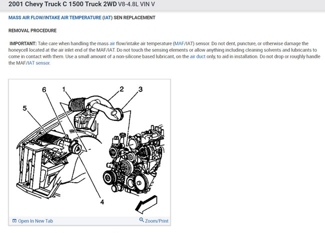

About two weeks ago my truck suddenly began idleing low and rough. At times it would die while sitting at stop lights. I thought it might be the fuel filter so I changed it and the problem still persisted. The spark plugs hadn't been changed in 30k miles so I installed new plugs. It doesn't die or act like it is going to die while at lights now but it still idles rough. Through acceleration the engine is very sluggish and rough. To the point it vibrates the entire truck violently. If you press the gas peddle to the floor for fast acceleration it seems to run fine. The OBD connection is not working for some reason so we cannot diagnose the problem using a OBD Diagnostic Scanner.
What is my next step? Plug wires? Rotor cap? Coils? Is there a way to bench test a coil if one may be the culprit?
Any suggestions would be greatly appreciated.
Sep 24, 2009 at 6:59 PM
QUAGMIRE86
  • 98 POSTS

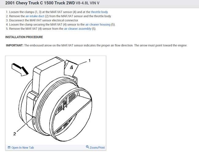

The problem sounds very reminiscent of what my truck was doing. Turned out to be a MAF sensor. Here is the location so you can replace yours. Check out the diagrams (Below). Please let us know what happens.
